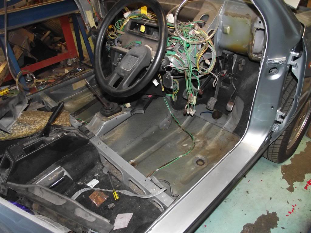

Started replacing the carpet:
Found the subframe's never been off in all this time:

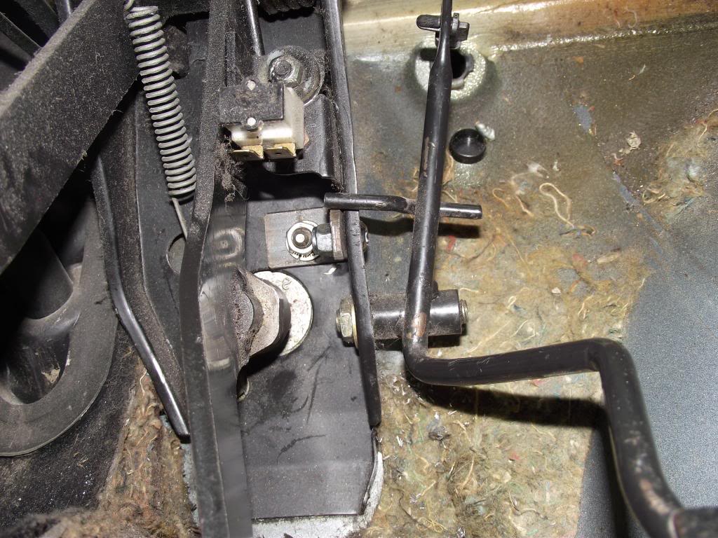

Modified the pedal box to stop it flexing:

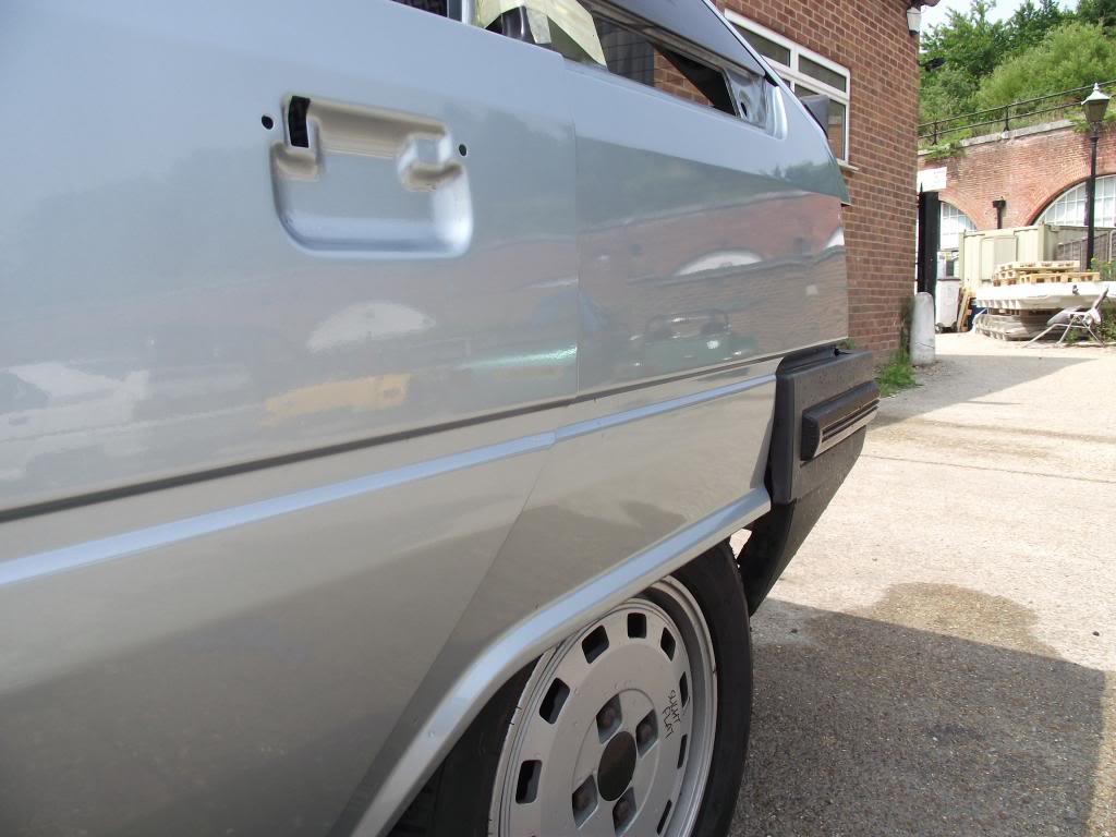

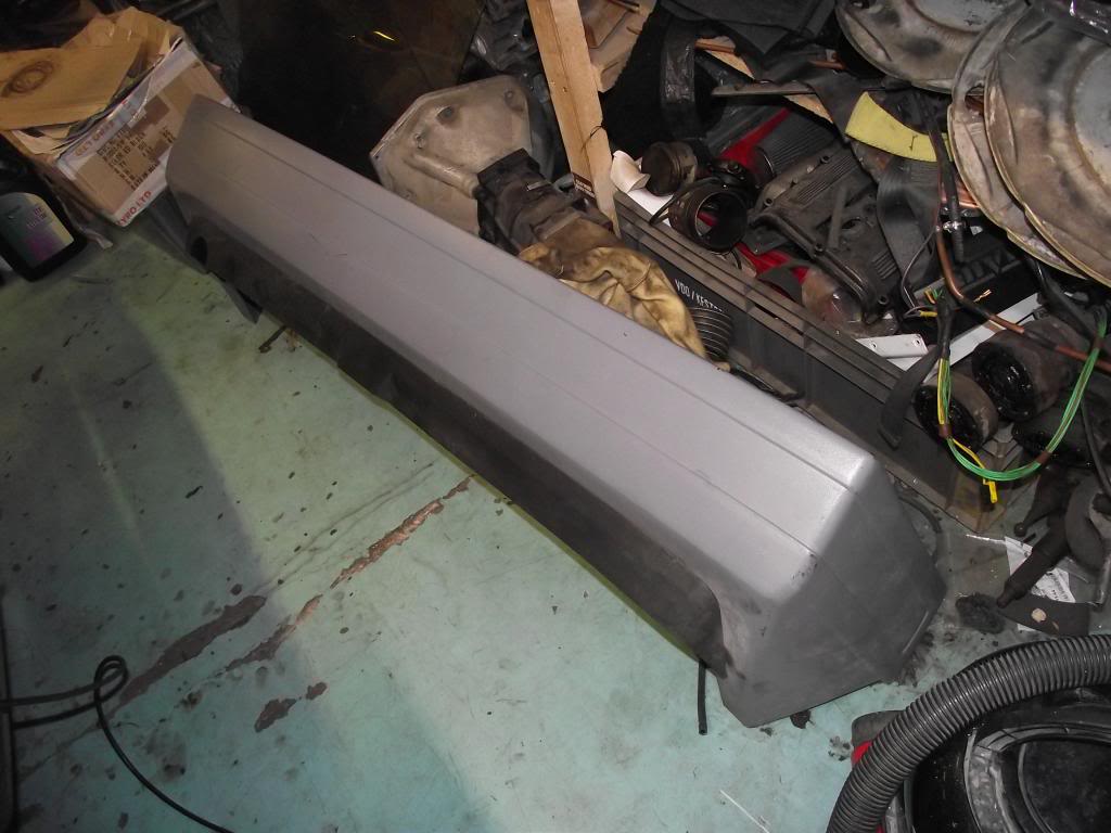

Admired the rear bumper I got for a steal on eBay (thanks RxBx for the link):

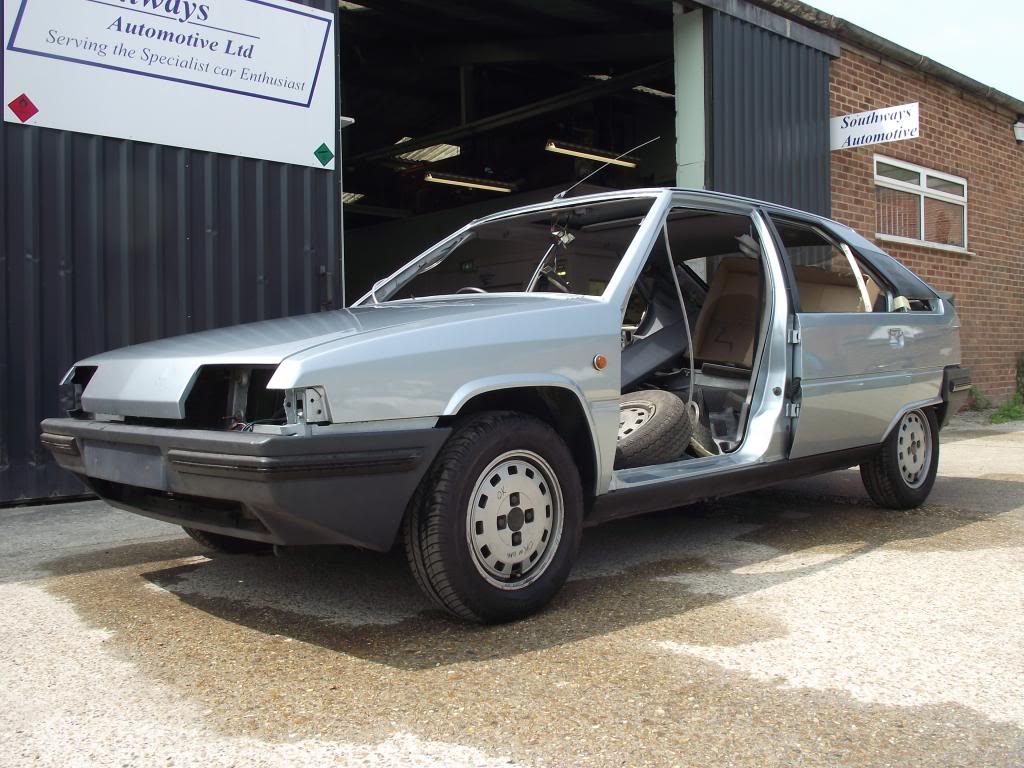

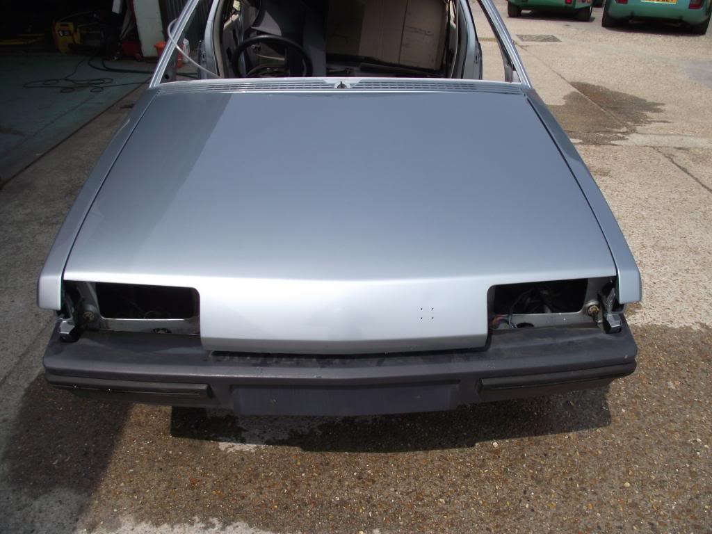

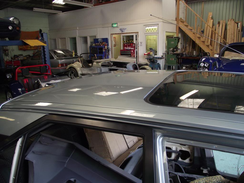

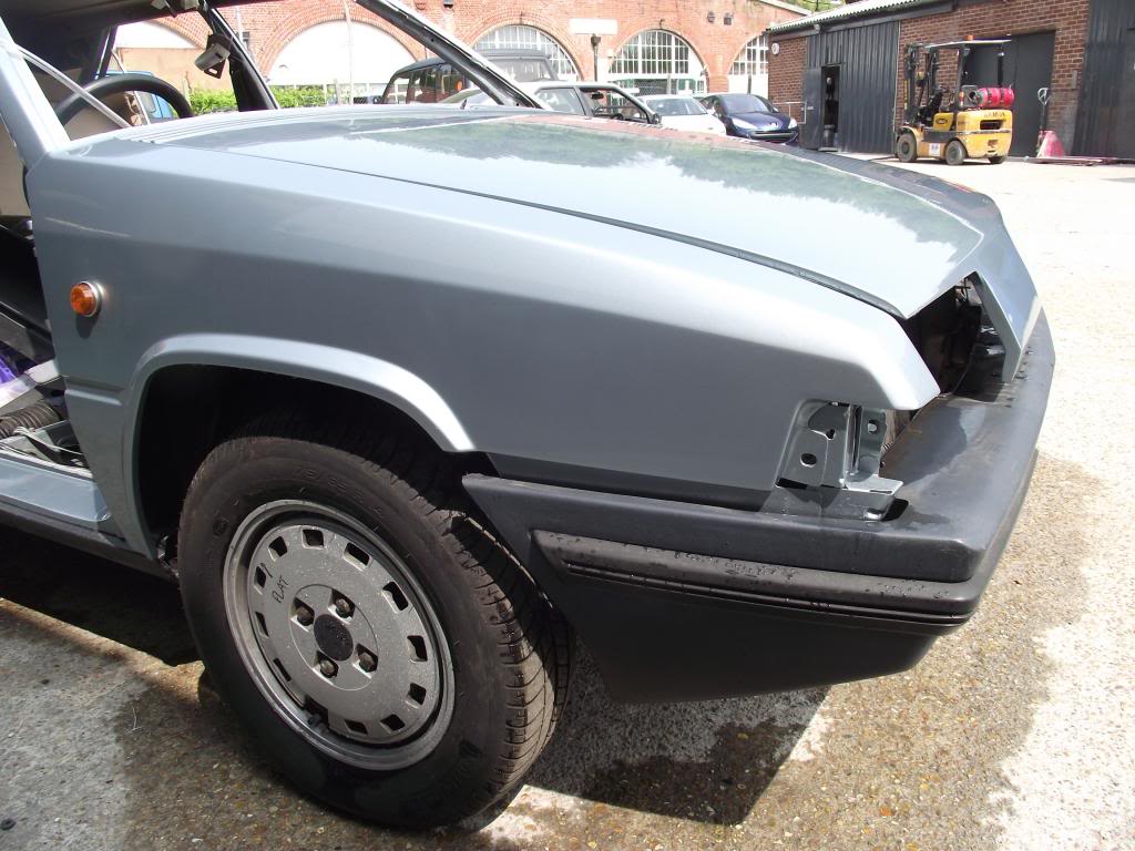

Loosely fitted some panels up. It's not a finished job by any stretch, but it's a good guide!
It's slowly coming on :)

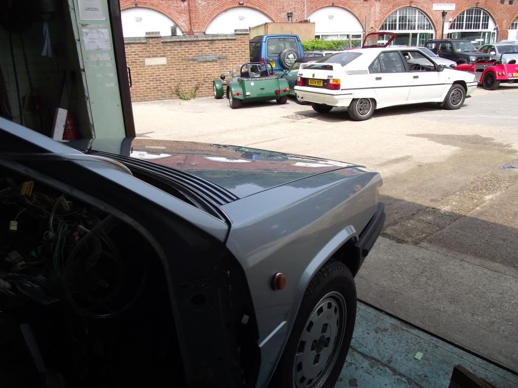

mds141 wrote:Liking the XR4i lurking in the background. :-)
My father in laws. Rustier than a rusty thing (well it was), but he's owned it since 1985 so we had to fix it really. It's taken ages!

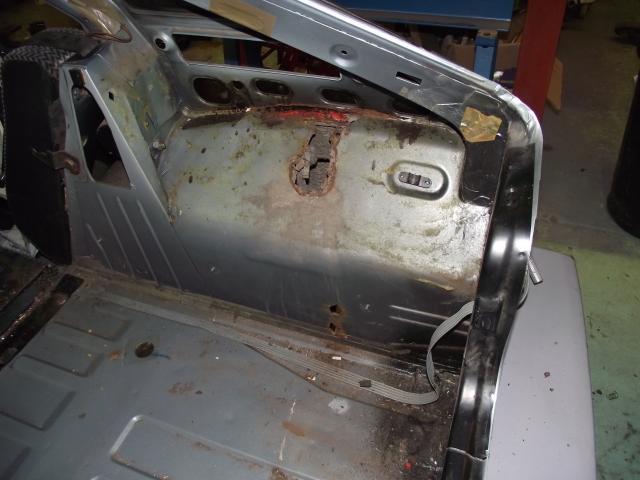

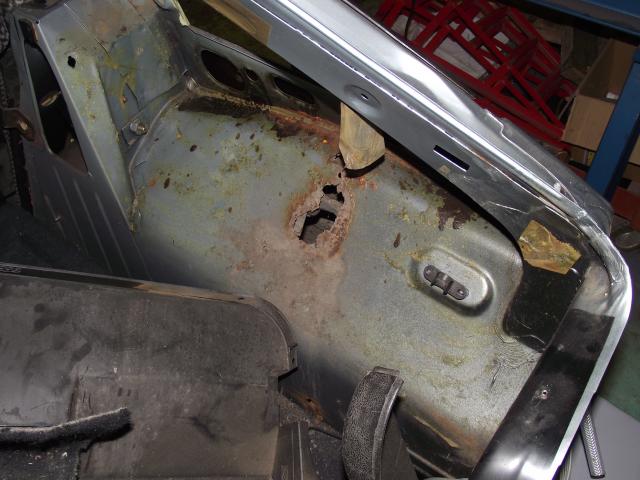

Bugger!

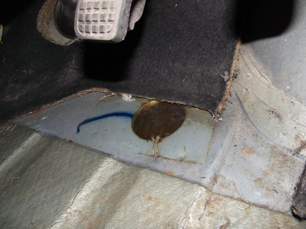

I only started peeling back the carpet to smooth out a crease in it! :roll: It's going to be a right bellend to put right too, as there's a section along the back of the quarter panel that this bonds to, and it's just missing.
Popped outside to look at G-SEG and see if (just by chance) there was a repair panel available, but it looks like it's a common spot for rot, so I'll be off to check out BAH soon!
Although it is the only panel in the boot of G-SEG that doesn't have a hole in it!
Posts: 15625
x 174
Re: Operation wake up GT! (no one has 56k anymore, right?!)
They all do that sir.
Yep - had to do the same job on the 14 I had - the top hole I think is due to part of the fuel breather system being clipped to the underside where it can trap dirt, while the lower bits look like where the support panel that stiffens everything up around the bumper end mounts is fitted.
standard. They ALL go there, and along the top edge, and around the outrigger.
The brace panel beyond it will be fucked too, and thats a wing off job..
Posts: 6431
x 91
docchevron wrote:standard. They ALL go there, and along the top edge, and around the outrigger.
Wing off? Not on this one it won't be! I'll have to come up with something! :lol:
