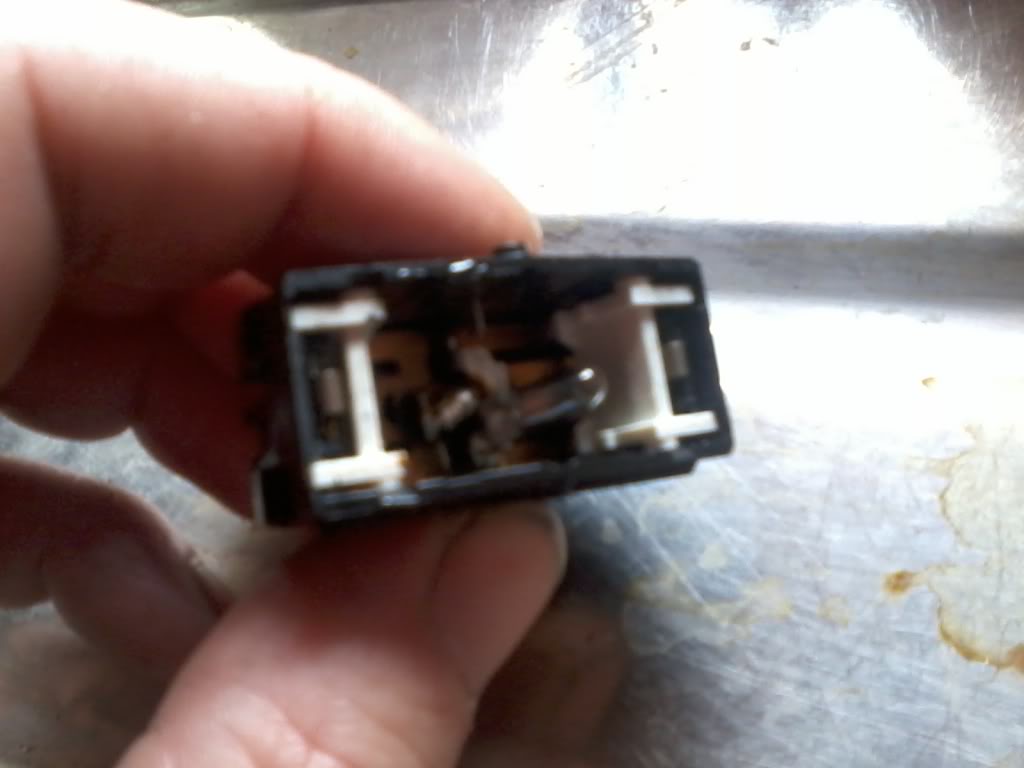

Today (reminded by Tim's request for one) I turned my attention to the mirror switch. Although it operated both mirror fine, the bulbs inside failed last year, and I've only now got round to sorting them. Very simple to pop apart the switch, making sure not to lose any of the spring loaded contacts. I only had one similar bulb in stock, so I had to raid another from a spare switch I had. The obvious suggestion would be to use LEDs, but I don't have any small enough, and I suspect most easily available ones would be too directional as one bulb has to lay on its side within the switch.
Back together with a smear of silicone grease on the contacts, and all should be well for a while.
