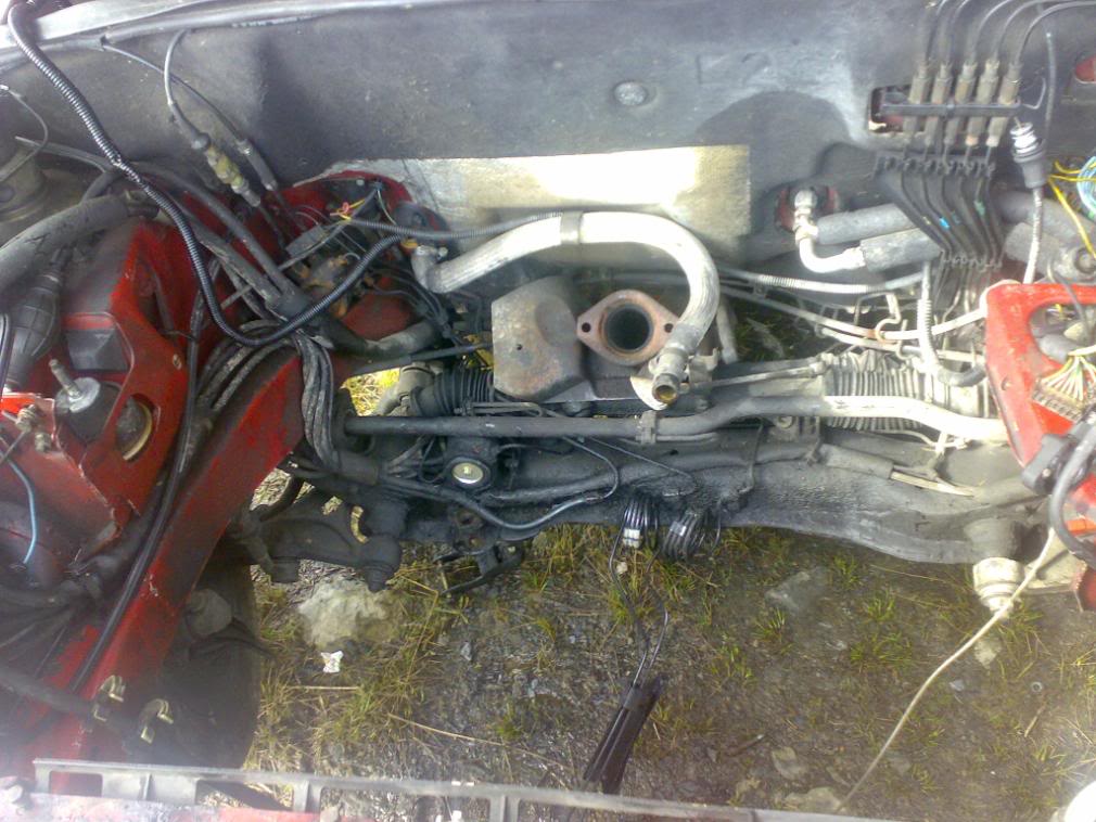

Anyway, I digress. My BX has been laid up for about 9 months as the cambely was due for replacement, and I didn't really see the point in changing the belt as I would be replacing the engine next weekend. Or the next. Or the next... Fast forward to now and I have a little more time so out with the old (going to find a new home down south with Kermit) and off with various bits to fit on the Xantia engine, such as sump (want to keep the air con!), oil cooler sandwich plate (smaller on the BX) and the timing cover (I prefer the one on the BX as it uses clips rather than bolts).

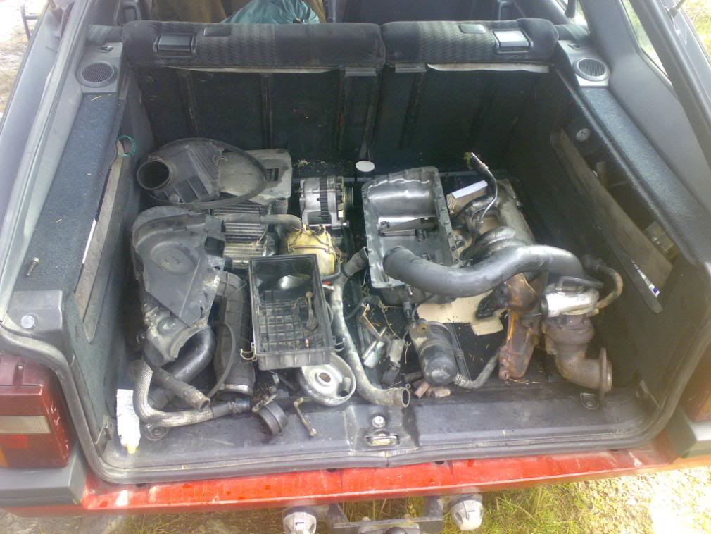

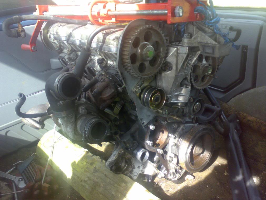

Not too much progress today, got the new engine a bit cleaner, fitted an almost new tensioner, new clutch, got the old water pump out too. Also changed the oil level sensor and the rev counter pickup, as the Xantia one had failed and mine is fairly new. The garage that serviced my Dad's car obviously liked silicone sealant - I'm sure the water pump was sitting at an angle to the block, there was so much underneath it :shock: but the gasket face looks in perfect condition :? Then rain and hail stopped play; but I did manage some pictures in the 10 minutes of sunshine that we had...
My BX
Something missing here...
Ah, it's in pieces in the boot...
Ready to fit to the new lump...
Before I get any comments about being well off given my choice of rags I had better point out that they are a worn out pair (but they do make nice absorbant cloths!)
Brings a hole new meaning to "leaving skid marks" really!!

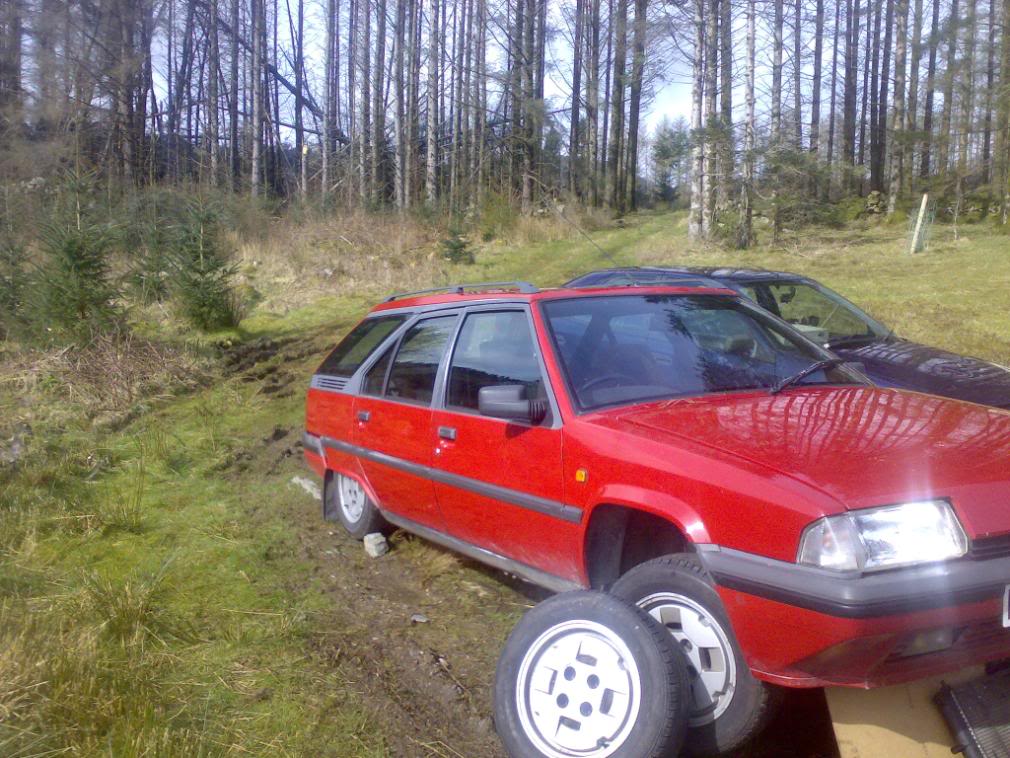

I think it's more a trick of the dark...as ours is a straight silver colour. Here's a photo on the day it didn't rain in Wales last year.
Funnily enough not a bad match for hammerite silver!

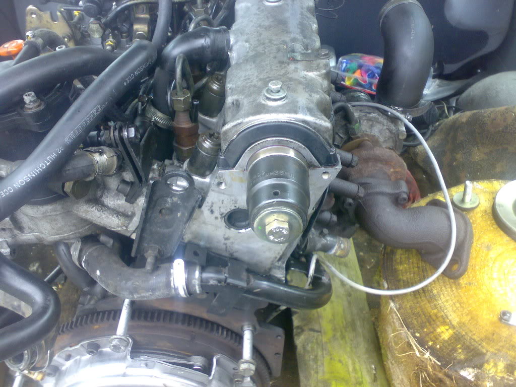

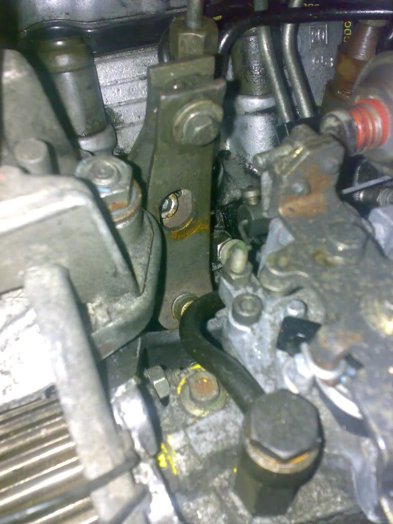

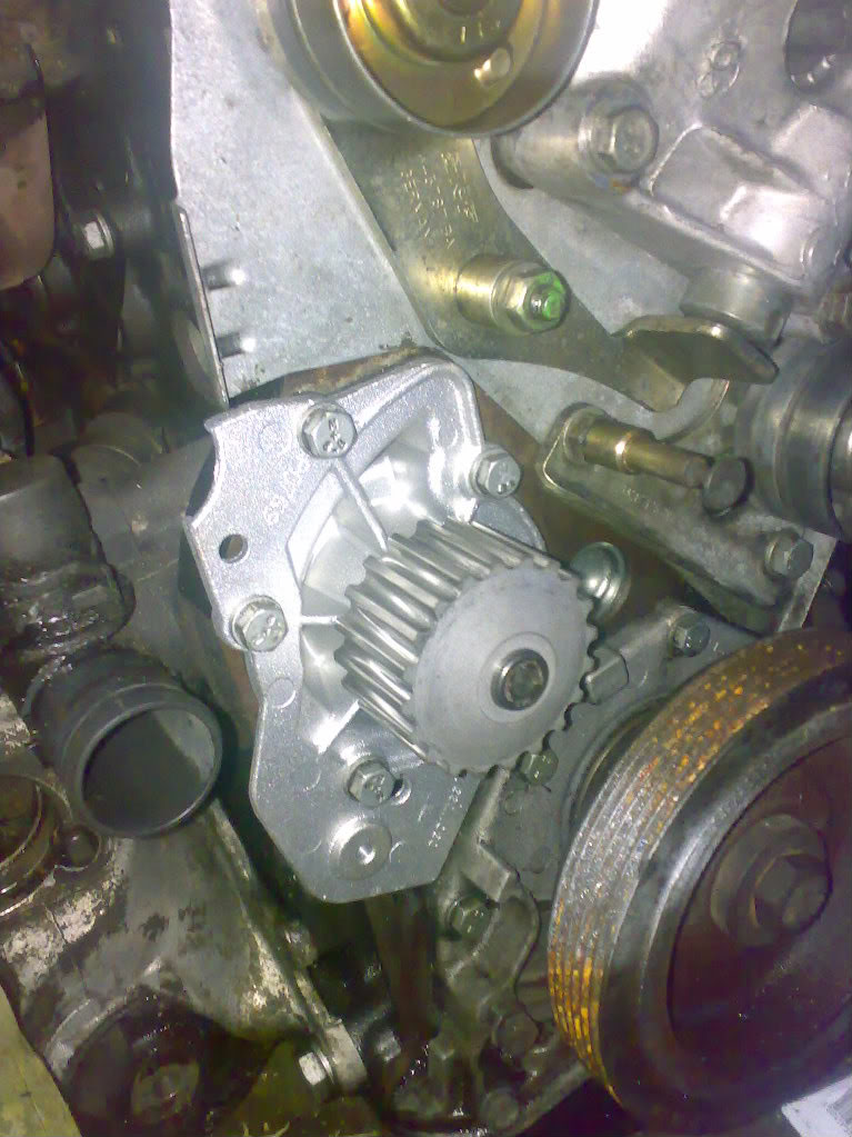

Yesterday I mainly boxed in some pipes in the bathroom, but I did manage to put on a new water pump...
...and fasten one of the intercooler brackets down properly.
It sits on a blanking off plate on the head, so I changed the gasket on it at the same time. The bottom bolt is a bit of a pain to get to, thank goodness for ball-ended allen keys!

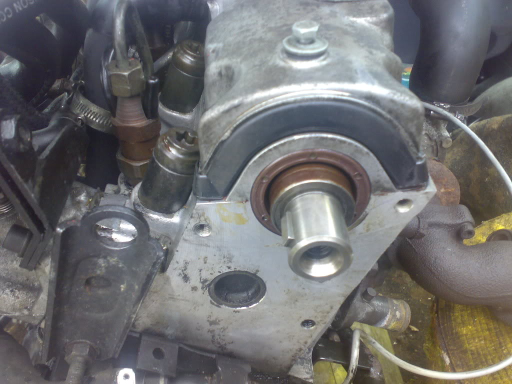

Today I have pinched some valve shims from a mate's scrap engine, set the clearances correctly this time(!) and put new cam seals in.
Off to the motor factors later (an hour round trip :( ) to get a new inlet exhaust gasket and then it's time to swap the turbos over.
