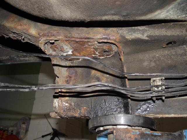

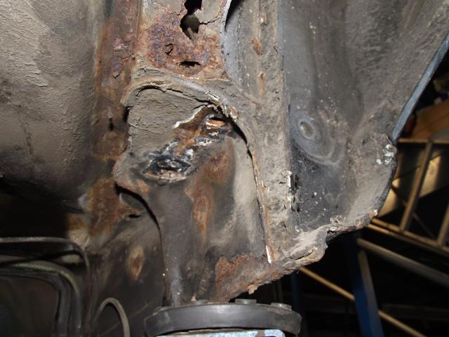

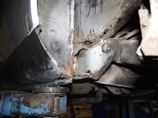

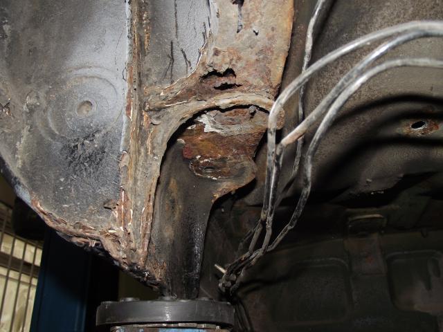

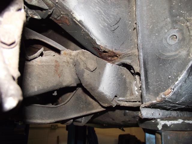

It got worse....again. Spotted some loose chunks of underseal on the rear chassis legs:

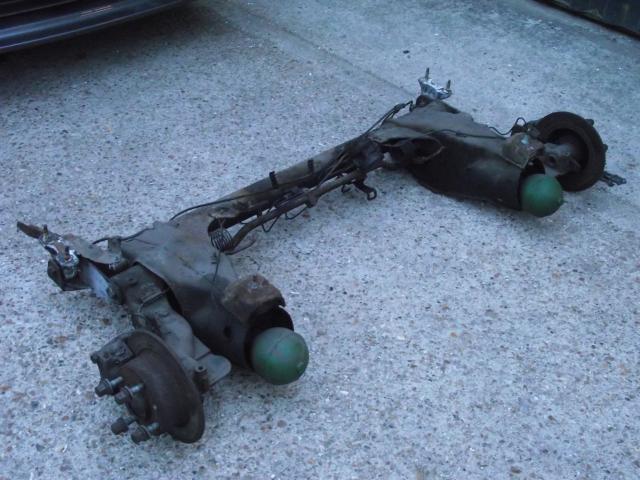

Rear subframe off to have a better look:

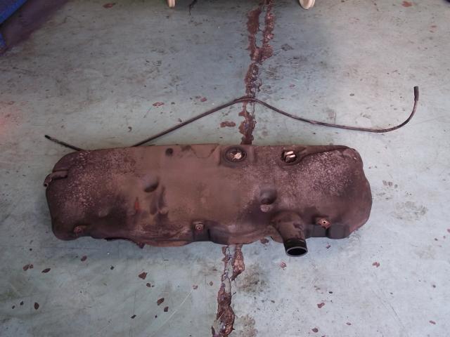

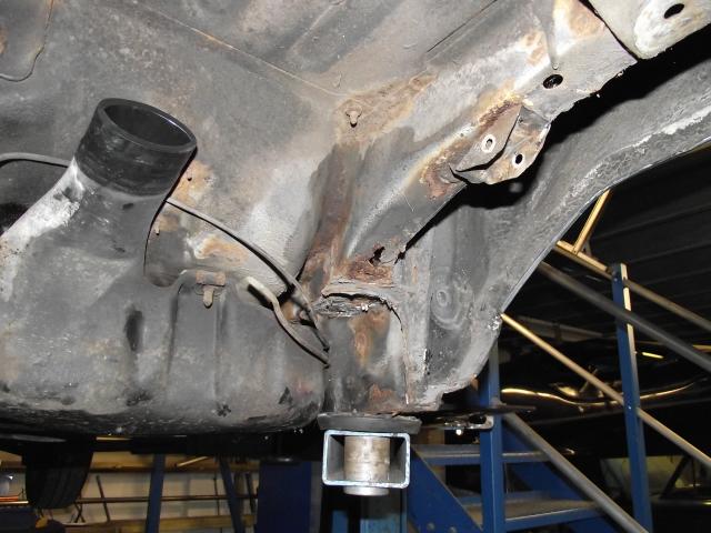

Fuel tank out to have a better look still:
It's all gone a bit wrong, really
It's also fair to say if all this had been spotted on day one, the car probably wouldn't have been repaired.
Annoyed that I didn't spot that, along with the crust in the rear arch. Going to be a right fiddle to put that right too - not quite sure how to attack it as the rails have gone, along with one of the subframe mounts which is inside a box section, so I'm going to have to creative!
Good job it didn't get voted in for the NEC

Kitch wrote:It got worse....again. Spotted some loose chunks of underseal on the rear chassis legs:
It's all gone a bit wrong, reallyIt's also fair to say if all this had been spotted on day one, the car probably wouldn't have been repaired.
I feel for you and have to agree; I wouldn't of bothered repairing one this bad. Question is now do you carry on?, I don't think anyone would blame you if you decided to call it a day.
