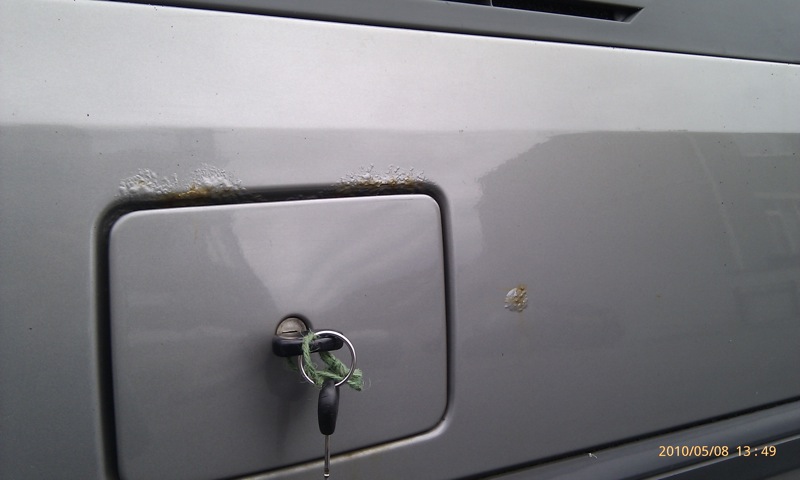

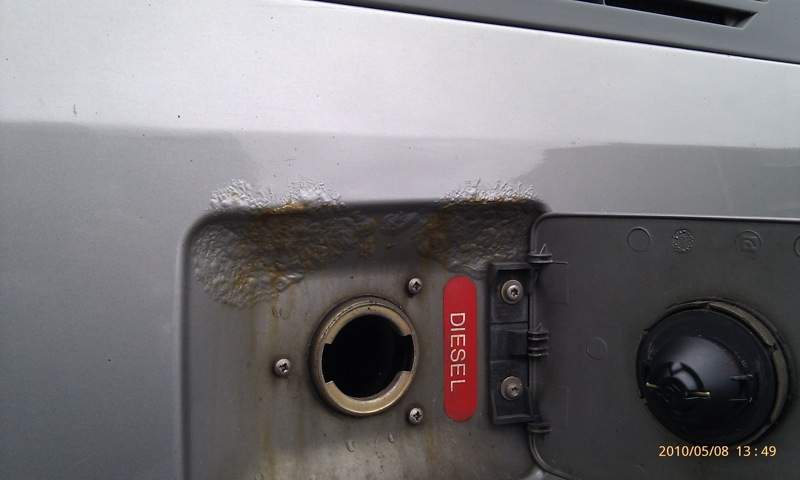

  • Rust around the fuel filler:

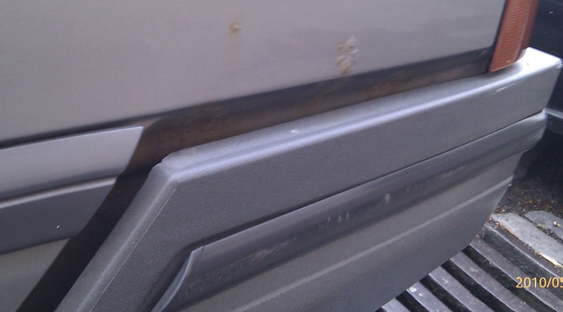

    Seems to be too much gap between the rear wing and top of rear bumper..

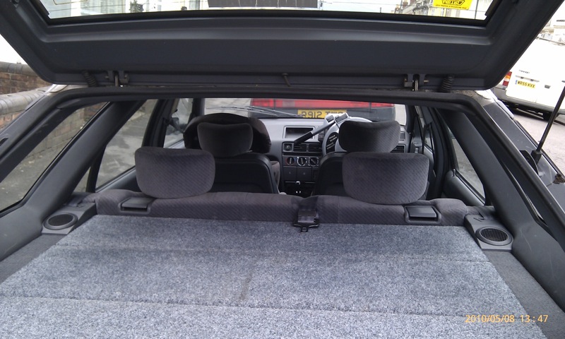

    Doesn't have the original parcel shelf but a well made DIY one:

Very nice and yes you did well especially with £160 worth of RFL. Pity about the rust round the filler but caught now shoudn't be a bad repair and it's only a small (cheap) & easy panel to paint on the estate.

Looking at the rear speakers - can someone much more knowledgeable than I tell me if these were estate only, or did this arrangement ever appear in hatchbacks?

Estate only, but they look a similar size as the one's fitted in the rear pillers, whip em out & get some proper 6x9's in, you won't look back honest. I was going to take some photo's of mine for the other thread, but i forgot & now Defender has my car up in Sunny Bolton way, so it'll be at least a week until i post them up.

Sorry for the slight thread-jacking, but I've been thinking of putting some 5" 2 way Blaupunkts I have on the parcel shelf, just have mixed feelings about hacking holes in it :oops:

what would be the best way to deal with the filler rust? Can you get to the rear of the panel from inside the boot?

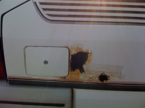

At least it's not as bad as mine.... :shock:

From the photo it looks like you may be able to catch that now without cutting it out. Clean it up thouroughly with emery or sand paper on both sides (I'm assuming you can get to both sides somehow on the estate) Then give it two coats of genuine Kurust followed by a filler primer then normal paint process. Followed by a liberal coating of waxoil on the inside and when the paint has cured you could even mask the outside panel and waxoil inside the flap area. You need to dig the rust out of any seams as much as possible and let the kurust seap into the seams.
Unfortunately Ray yours appears to be slightly beyond this :lol: :cry:

My brother says he could fix the panel, but I think I'm just going to replace it. Might have to hire a spot welder, though.

Nice car, those indents on the seat are from a baby seat and may fade with time, rear headrests too in the right fabric which is uber rare, the rear bumpers on estates arent a good fit as they are a carry over from the MK1 estate so I wouldnt worry too much.

Gave it a good wash today and found another area of rust around the rear bumper and a crease on the rear door..
