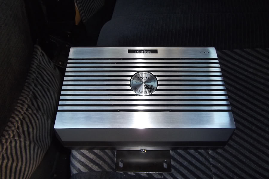

I recently spotted this little active sub at my local motor factors... £50, so I thought I'd give it a go. The thing I really like about it is the fact it is designed to fit under the seat. Most people recommend fitting a pair of them, but firstly I didn't want to fit anything under the drivers seat in case I need to get to the ECU; and secondly I didn't really want that much bass :lol:
Fitting...
At first I was a little sceptical that such a small bit of kit could actually provide any decent bass at all, but after a bit of fiddling with the settings I'm amazed! With the rear speakers disconnected, it still sounds respectable, and you only really miss them when you start going really loud. And this is with the standard 13cm door speakers. I have a choice of either Pioneer or Alpines to go in (from the AX or White BX) and I think the standard tweeters are pretty decent...

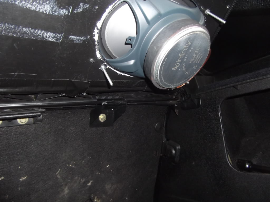

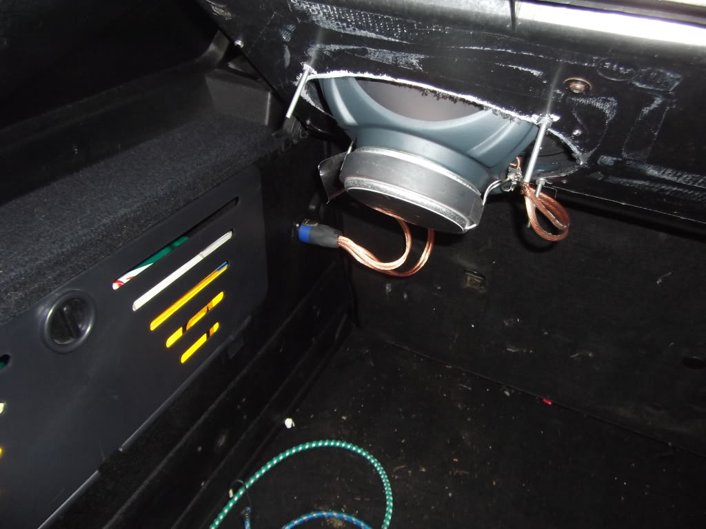

I bought these a couple of years back, and they've really only seen use since I fitted them in the car. Nothing special, and since fitting the sub, I'm starting to doubt their usefulness.
Although, I did finally manage to engineer a high quality quick release mechanism for the parcel shelf. Something that's always annoyed me is hard to remove shelf speaker cables. I was inspired by the system used in the Peugeot 306... and I found that the 'Neutrik NL4FX 4-Pole SPEAKON Speaker Plug Connector' was perfect for what I need. Still need to tidy up the bottom of the shelf a bit though.

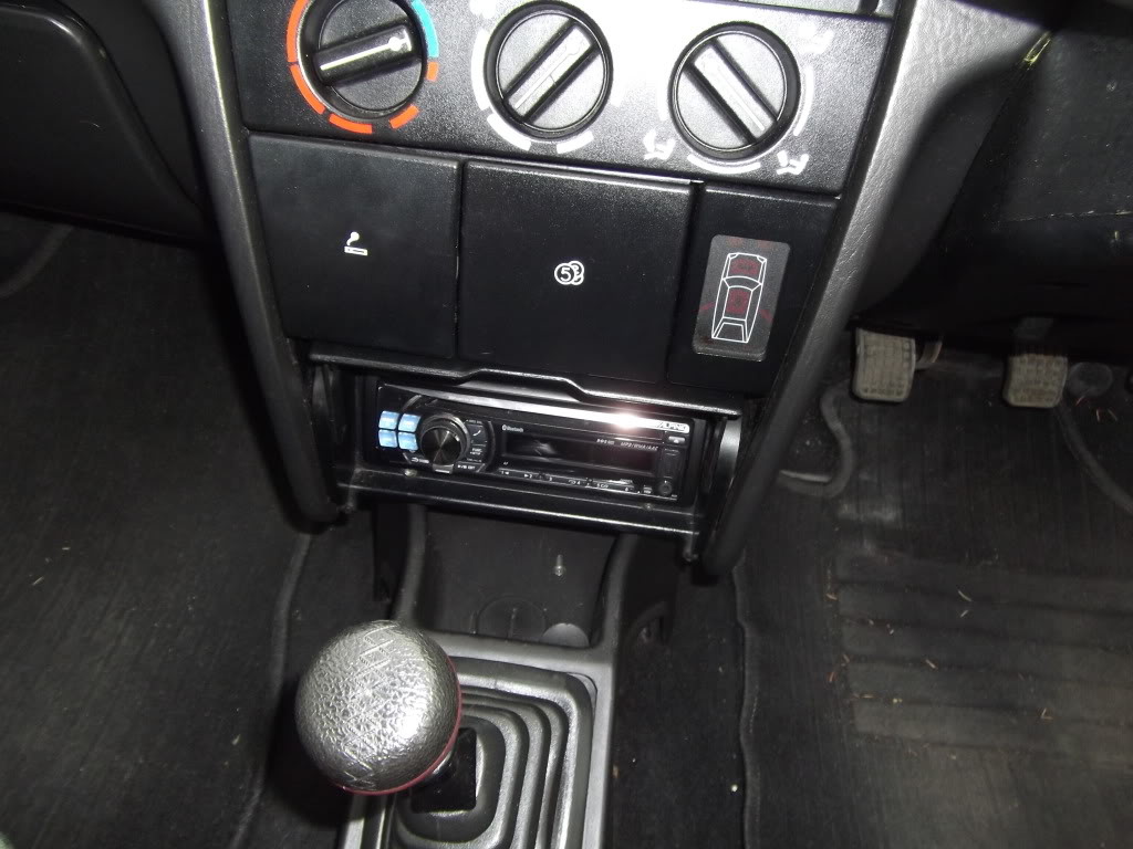

And the head unit. A rather nice Alpine MP3/iPod/Bluetooth?blah blah... does everything jobbie. I bought this because of the timeless, classy design. I think Alpines look good, without being to 'blingy' and flashing.
All in all, it sounds good. Still needs a bit of setting up, and the door speakers need sorting, but it can drown out the engine/exhaust of my 16v at motorway speeds, which considering the centre-box bypass pipe is no small achievement!

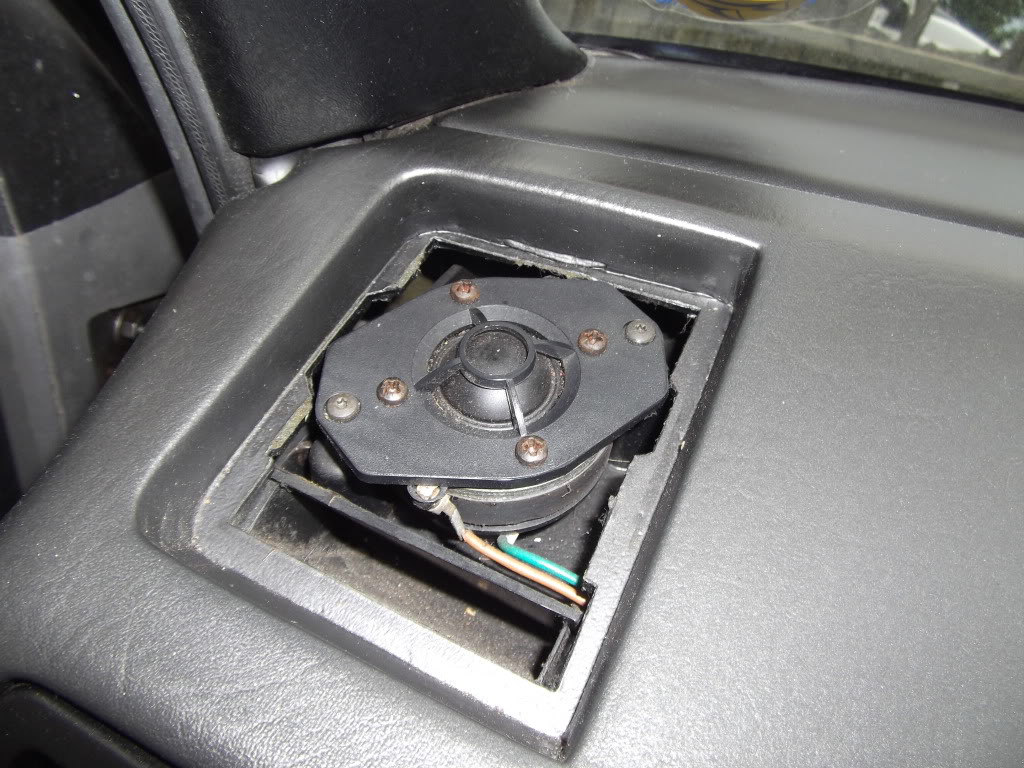

Some good looking stuff there. I'm after some of those tweeters if anyone has some - they sound pretty good, and screw in nice and easily. I have a spare pair of Kenwood tweeters, but they're not so easy to mount nicely.

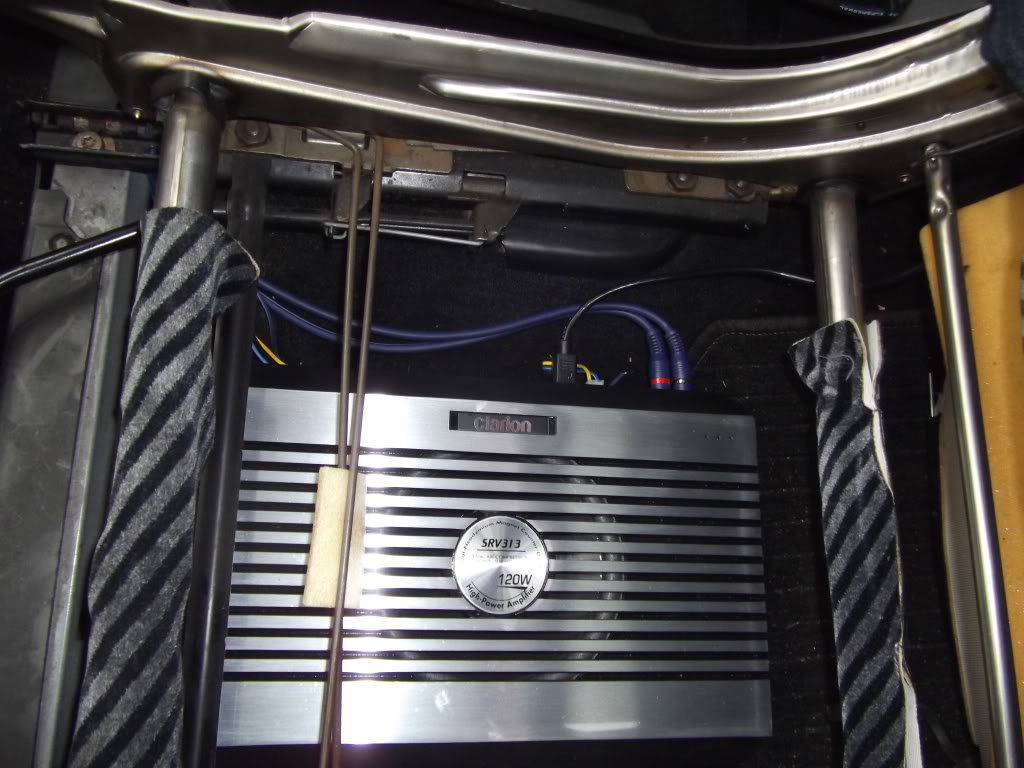

Just to resurrect this old thread - I've been doing some alterations to the sound on mine. First of al I've replaced the Pioneer bass tube (which lived in the rear footwell!) with the Clarion SRV313 which Matt H had. Part of the reason for this was the fact it meant I couldn't fold the seats down easily without removing it, and putting it in the boot would get in the way too. There is less deep bass than there used to be, but more than enough for me. Clarity is good, and it comes with a remote lead to adjust it without crawling under the seat to twiddle a knob.
As I mentioned before, I was never 100% happy with the sound from the front component speakers. I realised last week after driving the silver one a bit that at low volumes the original speakers actually sounded better! So after a bit of research I bought a set of Alpine SXE-1350S speakers, which do sound a lot more balanced. The other thing is they fit as though they were designed for the BX - the original yellow connector on the door loom just plugs straight in, and the tweeter is dead easy to mount in the dash (although you will need to connect it to the original leads somehow).
To replace the tweeters previously I had to cut out the originals with a holesaw, and glue the new ones onto the original mounting plate!
