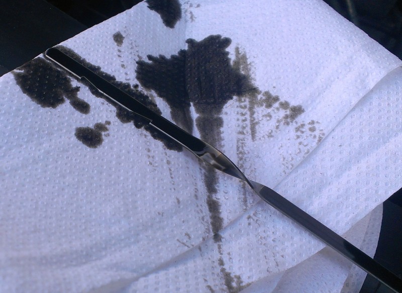

This is also what the dipstick said:
A little over the limit - I'm sure I wasn't that slack when I last changed the oil! I can't be sure but I think it has a whiff of diesel to it which could be a leaky injector...
I'll drain the oil tomorrow, clean the pipes and see what's what....
1988 BX 19 Gti 16v
1991 BX 17 TZD Estate
Re: TD massive over revving...
HOLY SHIT! thats enough over the limit to cause some EPIC issues..
I wouldn't even think about turning it over until thats drained down, and yes, if it smells dieselly then check the injectors..
