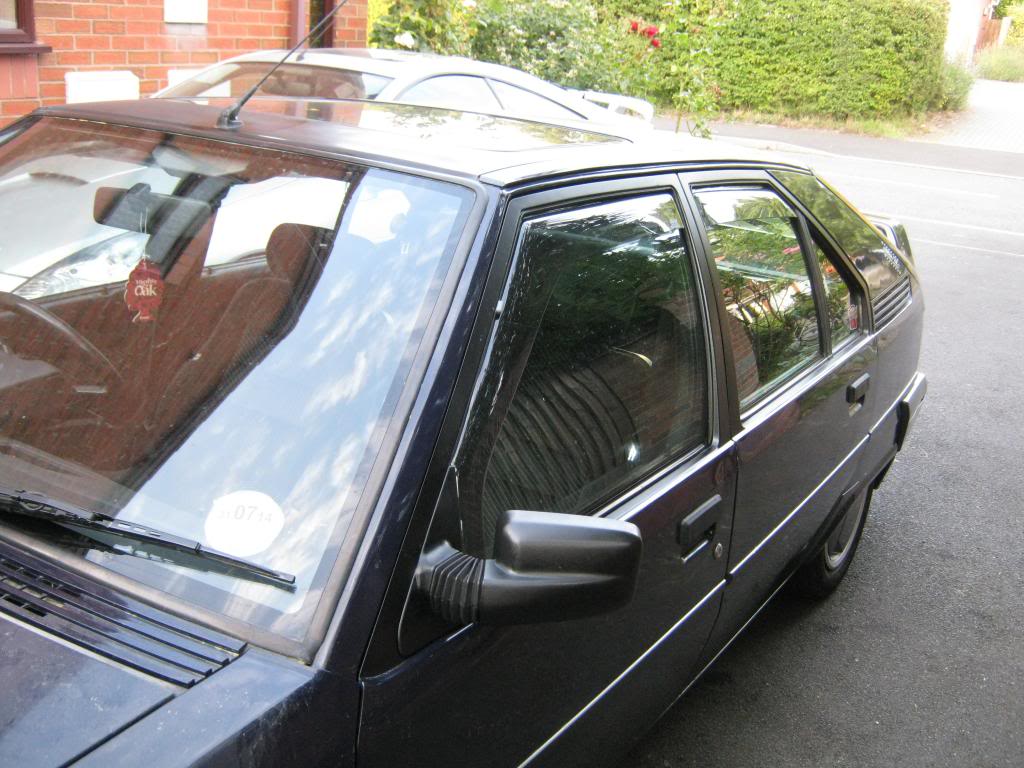

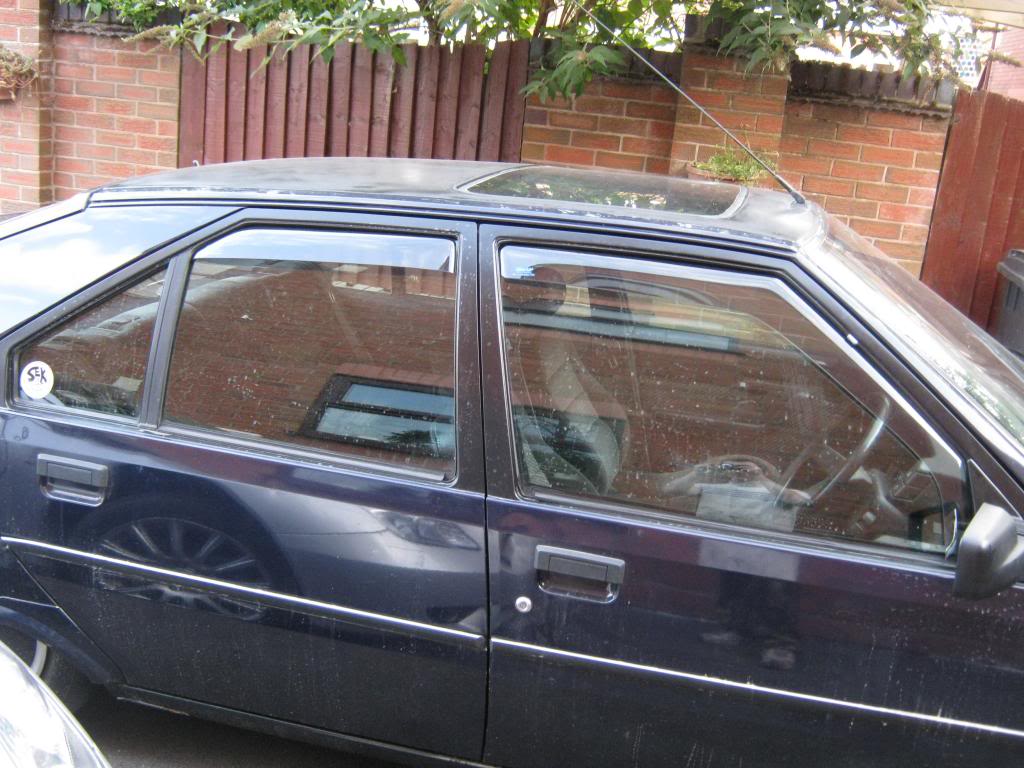

I've got Climair deflectors on mine, managed to buy them direct from Climair when they were massively discounted, which was nice! A smidge under £50 for the fronts and rears, I found I couldn't live without deflectors after having them on my first car (Mini).
They've been fine the whole time I've had them (only a couple of months), however fitting the front ones was a bit of a mission as I had to take the wing mirrors off (so door cards off) and file down the rear most corner of the mirror mount to give enough clearance for the deflector. Once I had the mirrors out of the way they went in okay, still a tight squeeze but then I'd rather it be like that so I know they're not going to fall out on me! Still, took me much longer than I initially expected to fit them - happy with them overall though.
Here, have some pics:
Oh and Bandit, the only reason I got the rears is for looks, I never have anyone in the back but I wanted the front and back doors to match

Hey they look great! Thanks Otter, you have convinced me that I need a full set and they really do look the dogs danglies. Are they a particular shade? Can you describe more how you had to modify the door mirror please?

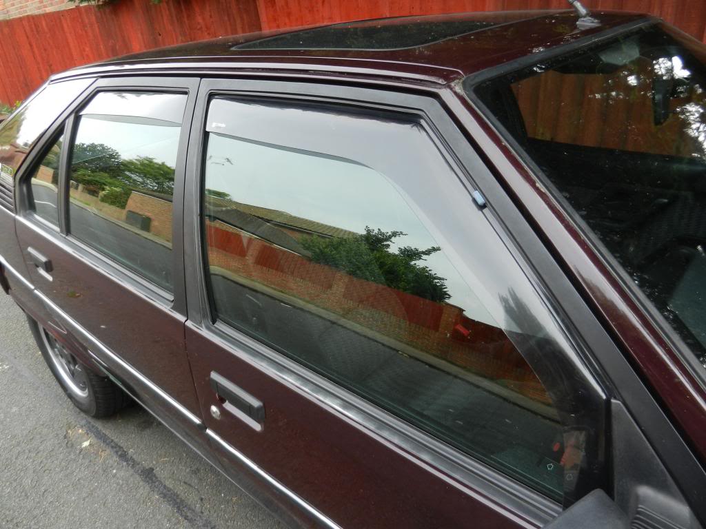

They look identical to the ones I've got on mine
I too had a bit of an issue with fitting the front ones. Got the edge by the B pillar in, then the top edge along the roof line, down the A pillar and then that last edge down the back the the wing mirror. I had a small file and took just enough off the corner near where the wing mirror plastic meets the rubber weather strip on the door. Had to bend them into place but like Otter says, I know they wont fall out.

Nice and deep too, the other makes seemed rather shallow in comparison. That is a lovely colour that Tizzy (that's the name of my dog!). I think that may well be my fave colour. Not seen any others in that shade! you need to get the top of your A pillar sorted out dude

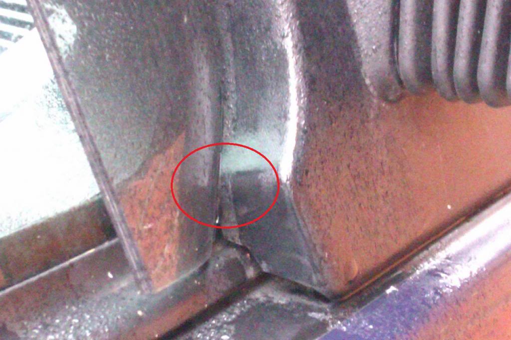

I took a close of up the area and circled the corner of the mirror mount that needed to be filed down:
It's not too clear there but that corner is pressed up against the deflector with some force (you can sort of see the film of water on the pressure point). I should have filed down the mirror mount a bit more really, it needed quite a bit taking off as it is there.
Oh and they aren't any particular shade no, there was no option to pick when buying them so they're just normal smoked plastic.
