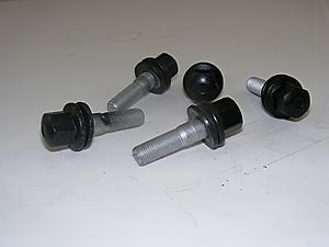

Re: WANTED: wheel bolts for Speedlines
Absolutely spot on Guy's, its PER stud-bolt, as I priced then up last month or so before letting go of my last spare set !
Malcolm, The part number was 95 591953 and then changed to 96 070416
There is though, an issue of the bolt length as there are at least 2 types. Are these the longer bolts as needed by the BX Alloys?citronut wrote:here is price and part No. from citroen
96070416 MOUNTING SCREW 5.02 GBP 6.02 GBP 6.02 GBP
the same part/No. fits these models
SAXO
BX
XANTIA
XM II
XM
i dont know but it is the only wheel bolt showing for BX alloys, and it does not give the bolt length, but just its diameter and thread pitchWay2go wrote:
which is 12mm X 1.25
Malcolm your 100% correct !citronut wrote:i dont know but it is the only wheel bolt showing for BX alloys, and it does not give the bolt length, but just its diameter and thread pitchWay2go wrote:
I don't why 'Way2go' has Muddied the water , as this has been covered many times (Even with 'W2g' posting in one particular thread which I've linked up below) which is the most clearest one on this subject and the importance of using the correct 'Stud-bolts' - Click on image for link to thread
__________________________________________________________________________________________________________________________
Also just to confirm the length of the 'Stud-bolt' = 46mm (From under the head, rather than the washer) !
The /\ quote from THIS thread for ref.RxBX wrote:........
That's not quite true, as the same stud-bolt on all Speed-line alloys fitted to the BX TZD/GTi & 16v (5-1/2" J and 6"J) were also fitted to the early Xantia Exclusive models which also had the identical length of bolt of 46mm (That being measured from under the head rather than under the washer) !
However when the very late XM's were coming of the production line, the alloys were change from 'Monte-Carlo' to 'Ville de Monte-Carlo' and 'Etoile' to 'New Etoile' when the stud-bolt length reduced in length to 42mm in length (again measured from under head) this was to compensate for the revised/thinner section thru' the alloy wheel/hub, see THIS PDF for more info page's 9 and 10 of the brochure (11 & 12 of 14 on the thumbnails).
IIRC this revision also applied to the later Xantia range/styles which sported alloy wheels, but the BX Speed-line's stud-bolts have always been 46mm in length !
Mat F, surely a 'Sticky' (Or some book marks to the threads /\ in the 'Technical FAQ & Mod's' section) is needed on the 'Stud-bolt' issue so as not to have folk keep repeating info on this subject which is of great importance due to the safety issues as 'Boxwolf' and others have found out by using the incorrect ones (Usually from Pug fitments) !
Only just seen this properly (still no laptop ) but I'm not sure how W2G has "muddied the water"? A part number had been posted, and the question was asked whether this corresponded to the longer bolts required by the BX Speedlines. To anyone who may not have known, their attention had been drawn to the fact there are two similar (apart from the length) bolts out there.Way2go wrote:There is though, an issue of the bolt length as there are at least 2 types. Are these the longer bolts as needed by the BX Alloys?
You could argue that pretty much every technical question imaginable has been asked about the BX, so everything should be covered by using the search function. But it's not a perfect tool, and without the live 'chat' IMO the forum would become a stale and dull place.
I may be in a minority here, but I don't believe that anyone should be dissuaded from seeking clarification. I can't find anywhere on the forum where the length of part no. 96070416 has been confirmed as being 46 mm, although as it appears they're the only ones listed for the BX then we can safely assume this.
