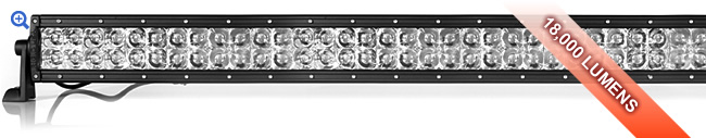

Or go mental with something like this
Actually i'm surprised Mr Fenwick hasn't suggested something like this already!
