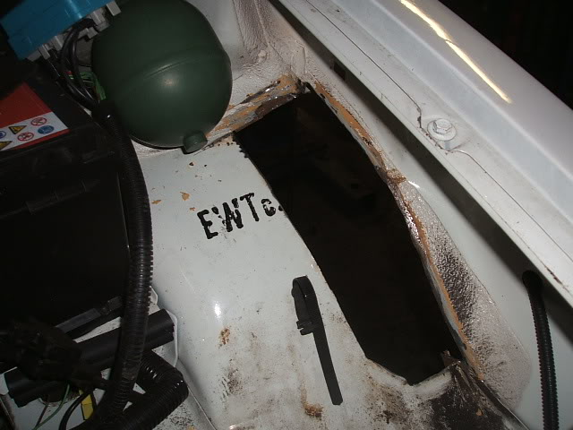

Usually on inner wing 3 letters. Or poss on the A pillar door hinge side. Or vin plate?

Paint code should be on the N/S inner wing, IIRC the bolts for the rear spoiler are inside the tail gate. The bolt holes are covered with a bung I think. They may however not undoe without doing more damage o the spoiler.

That's not right, I haven't got a hole there.Defender110 wrote:

I think that piccy is of my old TXD?
