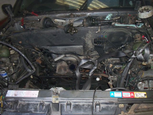

prepping to make my own "octopus" ...
the old one.. was old..
so i found out what all of the pipes do and what pipe connects to what... and i found out that the octopus is in 3 parts.
and where i have cut it, there are no internal pipes
as seen:
so that said, it looks like this thing would be quite easy to make out of simple T pieces and say 6mm push fit tubing (which is rated at a 10 bar connection! 16 bar for the other kind!)
