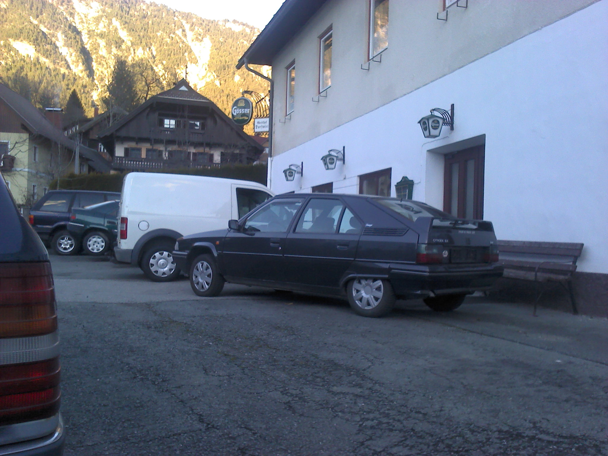

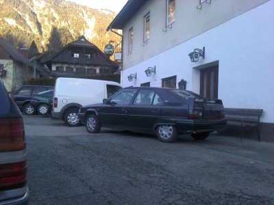

And here's the pic of her on the day she arrived home. Just testing the new pic upload feature.
Own Copyright xjs36uk BX16IE IMAGE Austria

Looks good from here!

From 1000 miles away I'm sure she does !
Actually she looks pretty good close up too.
