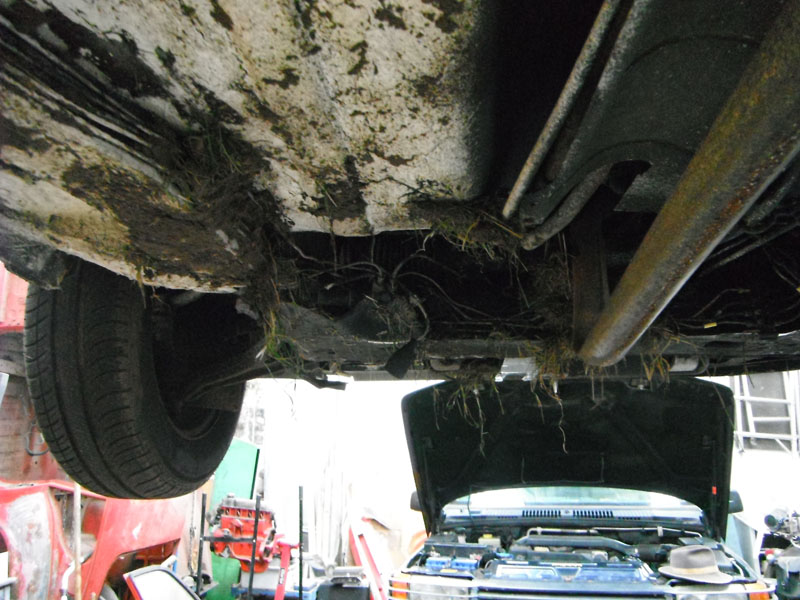

There was still plenty of mud and grass underneath from the landscaping the car had done to Dean's access road. A quick scrub with a soft wire brush got rid of it all and while there's a few spots that underseal needs redoing I couldn't really find what had stopped us getting off the truck. The exhaust was slightly misaligned so I'm going to go with Dollywobbler's suggestion when we were loading that it was the centre exhaust pipe clamp which looked pretty new with long-ish bolt legs. One thing I did notice straight away was a plug hanging down near the pipes at the back of the front subframe. It was easy to see where it came from so I wondered if this might just be the easiest fix in the world for the STOP light Dean had mentioned had stopped working.

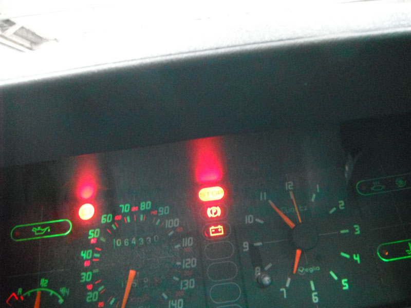

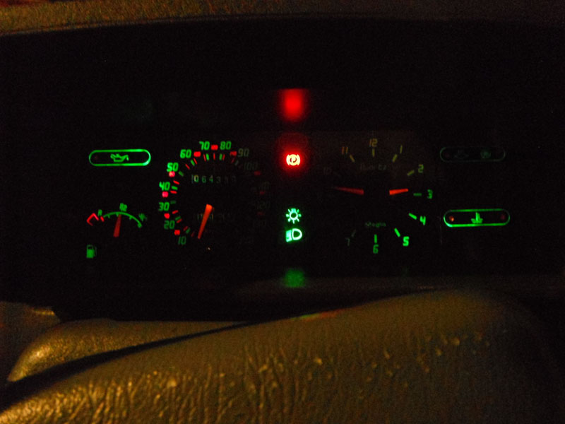

Clean it up plug it in and...

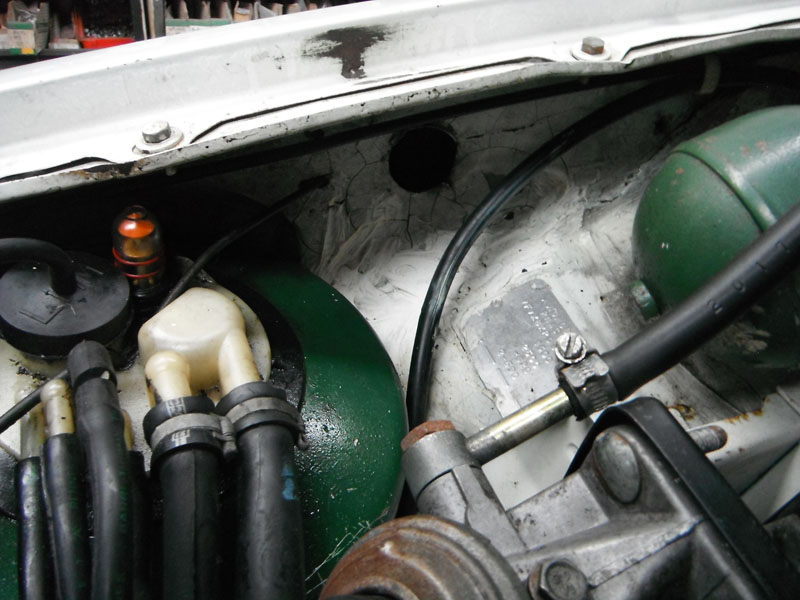

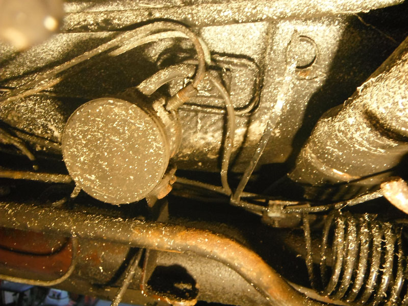

Who said fixing hydropneumatic cars was difficult? I'm sure doing the front-to-back pipes will be a breeze now, right? RIGHT? Er... yeah. I spent some time trying to figure out where the leak actually was and where the pipes went. I could identify the two pipes that had already been replaced and the two pipes that hadn't, one of which looks more scabrous than the other. The leak itself is hidden from view somewhere above the rear passenger sphere, which lends credence to Dean's assertion that it's the front-to-back pipe over the subframe that's popped, as if there was ever any doubt of course.

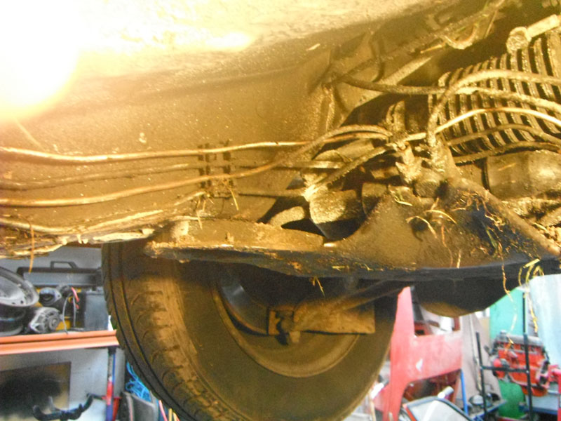

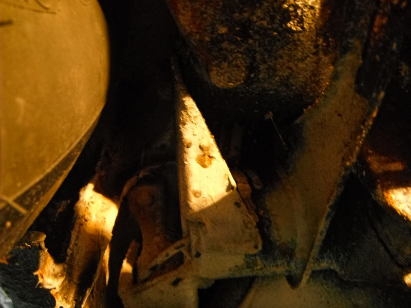

Then I got a bit stuck. I couldn't trace the route of the pipes because I couldn't see exactly where they went around that bit without removing the subframe. To help, I removed the back half of the exhaust, which was simply a case of undoing one clamp and unhooking a few rubber hangers. This allowed me to see better where the new pipes had been put so I could do a better job of tracing. It looks like one pipe I need to remove goes into the height corrector unit (the round thing to the right), and the other looks to go into the multi-pipe block to the right on the subframe crossmember. I got the union in the height corrector unscrewed but the pipe itself won't come out of the corrector unit. The pipe feels fragile too, in that way rusty steel pipes do, so I'm concerned that if I put too much force in I'll snap the pipe off and give myself too much work. Help would be appreciated on how to proceed here, I don't want to fluff it up. (EDIT: some help and advice has already been given by Dean, so I know a bit better what to do. More help and advice welcome on any BX jobs I'm facing anyway, I'm all about sharing info and solving problems with these threads).

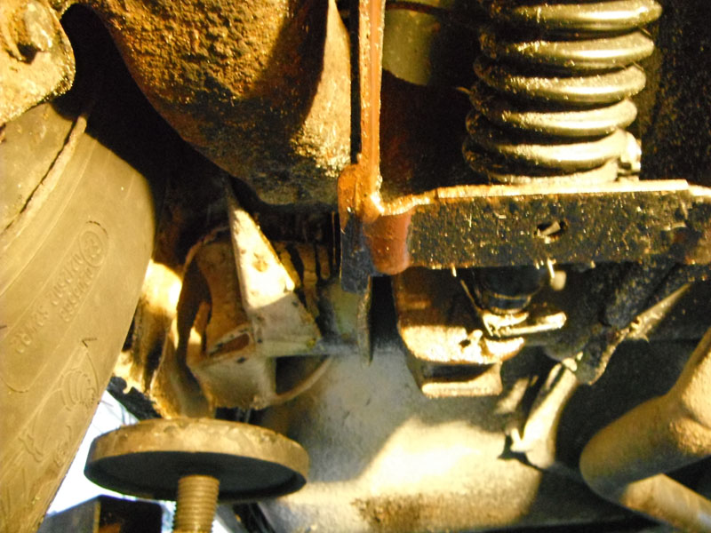

I traced the lines to the front of the car, and it looks like the both end at the vertical valve/union block to the right in the second image below. I couldn't see where else they might go and the manual didn't provide much help on removal and routing of pipes.
I decided to put this part of the job aside and seek advice. I don't want to remove or damage things I don't need to. It does look like a fairly straightforward job once you've identified which pipes require replacing.

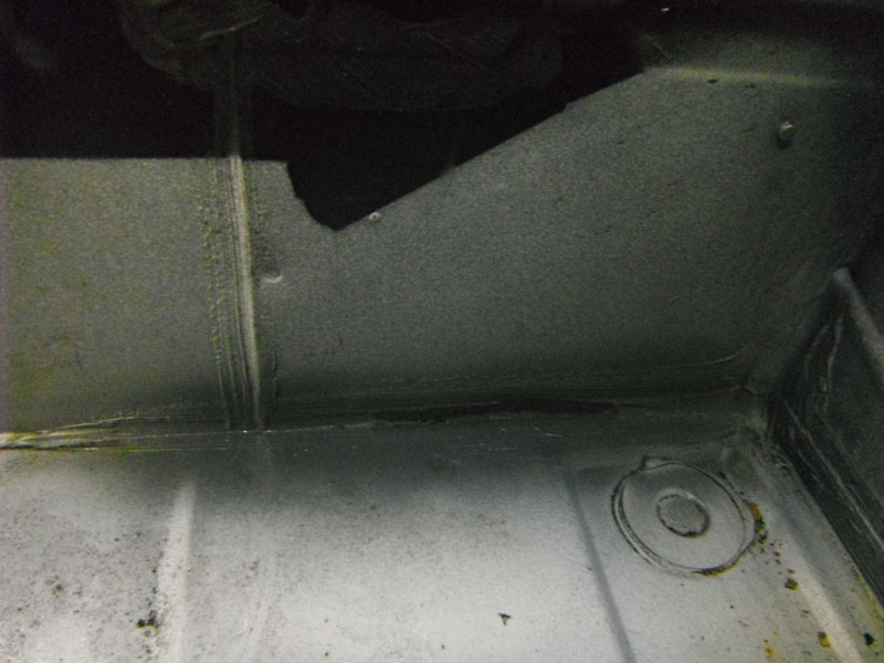

Since I couldn't go further on the suspension side of things, I looked at what I could do. Since this is a BX, rust is a concern and thanks to the estate I used to have, I knew where to look. This car doesn't really have much rust to speak of and being white, any rust it does have is going to be very visible. I knew about some spidering on a rear wing which, unfortunately, is going to involve repainting rather a large section of the wing to correct. It doesn't seem to need any welding at least, and it is very difficult to see, so this is low priority.

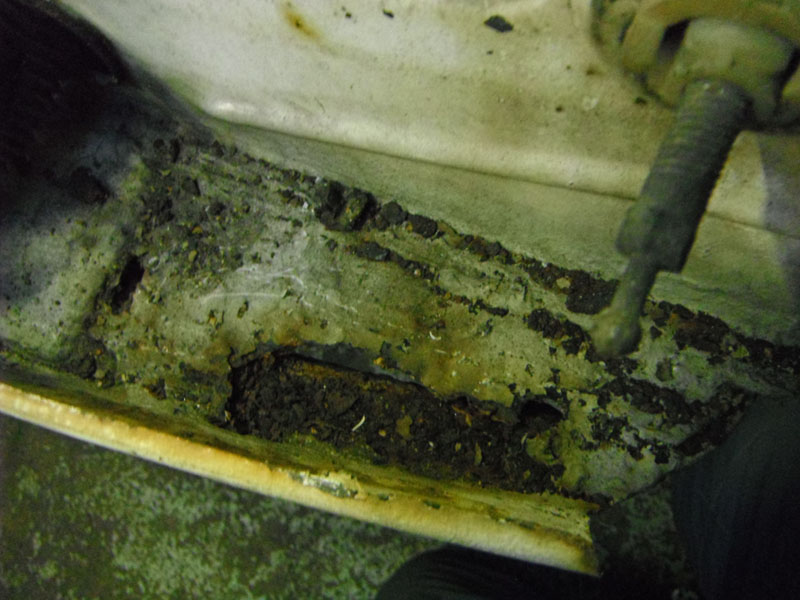

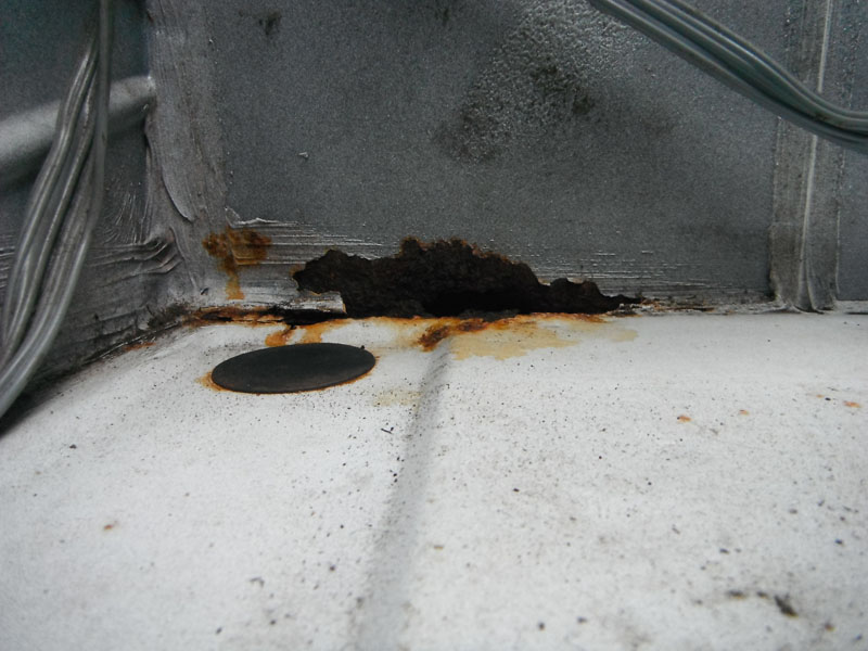

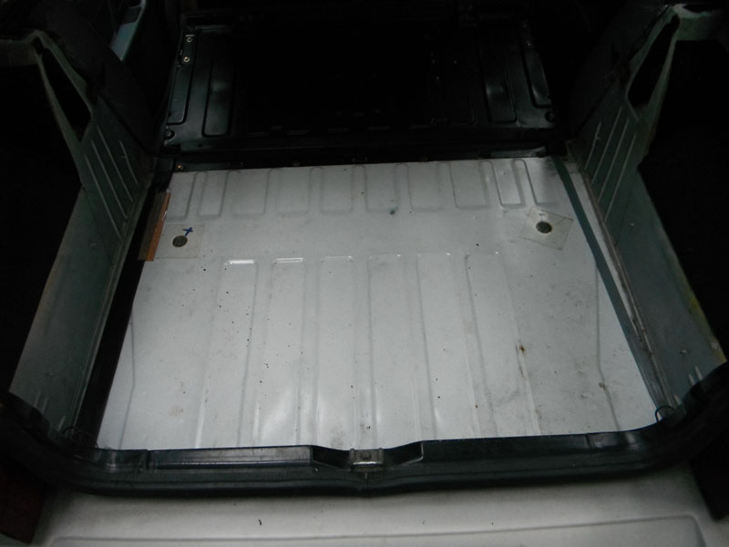

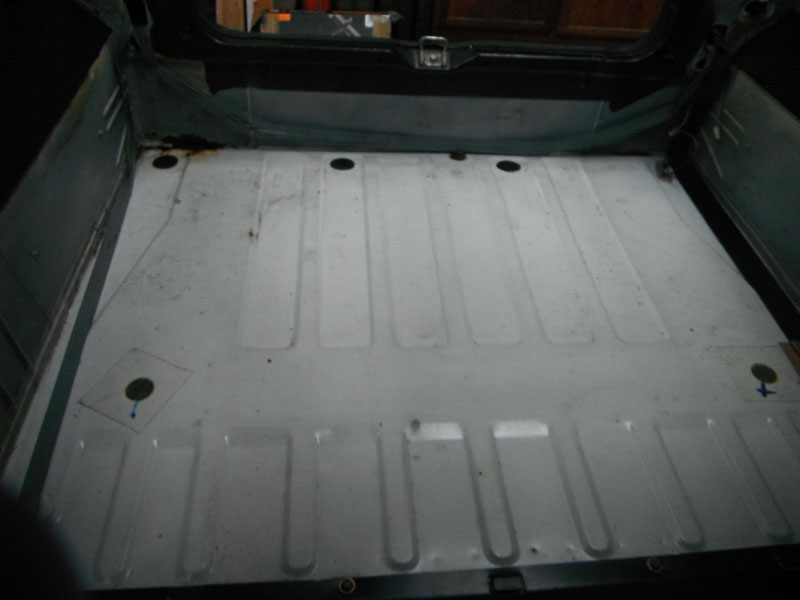

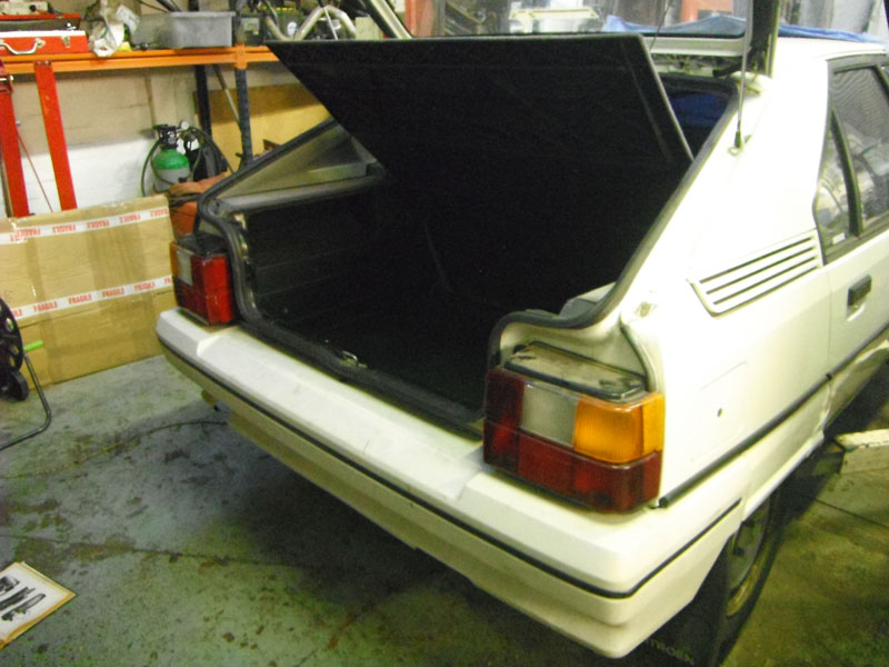

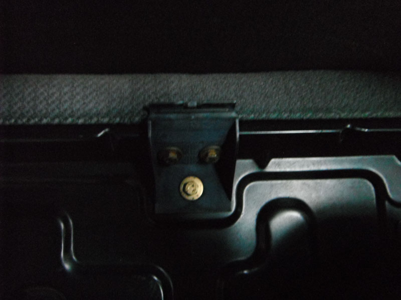

The other big weakness is the boot. I put my big boy pants on and started stripping out the boot trims, knowing just how frightening this part can end up being. Amazingly, it's incredibly good underneath everything.

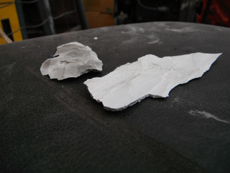

There's just two small areas that require some attention. A small section of sealant has failed on the passenger side, and some rot has begun on the driver's side. This is all flat panels with excellent access so shouldn't be bad to fix at all. Looking underneath the car the inner arches are remarkably clean, and the rear apron is in excellent shape. I'll remove the bumper to do the repairs properly and get everything cleaned, painted, and protected to keep it this good once the welding is done. This was a very pleasant surprise, I was expecting this area of the car to be much worse even though it looks so nice on the outside.

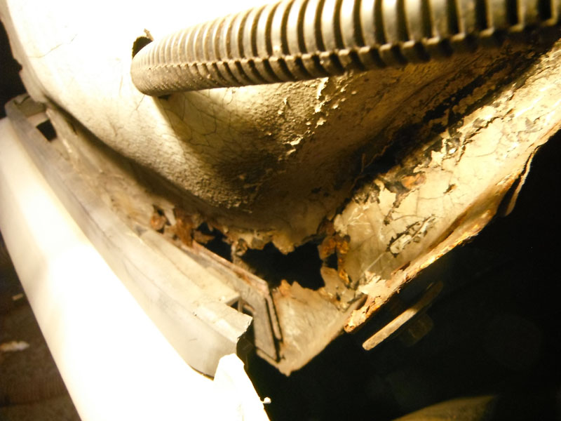

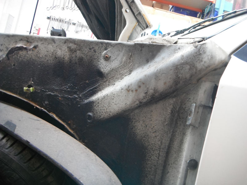

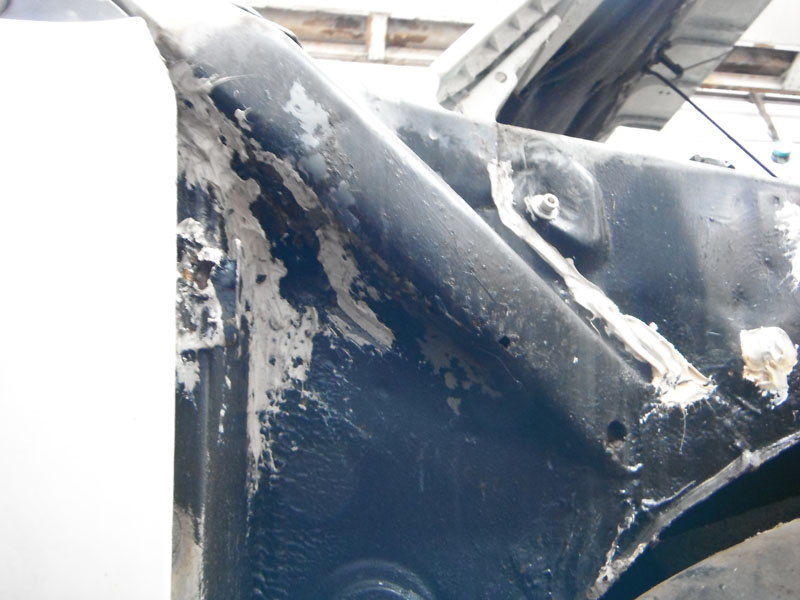

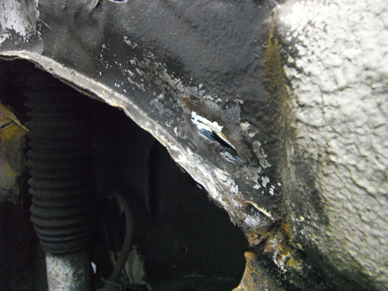

Up front I wanted to check out the only other bit of rust of note which was the inner wings. This is another common BX weak point and worth exploring. There was some foam-backed stuff applied to the inner wings and when I noticed it was holding on to water I decided the best thing to do was to whip it all off and deal with whatever was lurking underneath. Absolutely no point pretending it would be okay and letting it fester since I have the luxury of time and space to sort this out. Amazingly, it really wasn't that bad at all, just a bit ugly. The damage that is there appears to be localised to the bit where the vertical inner arch meets the horizontal, with a little bit in the nose on the passenger side. The driver's side nose piece seems very solid. I also had a look at the front crossmember that was advised at MoT and that too looks like it only needs a fresh bit of underseal to replace the bit we accidentally removed and is otherwise very solid. I will remove the front wings, lights, and bumper to rectify all of this since it's all very easy to dismantle and then make sure there's plenty of paint and protection applied to keep it good afterwards.
This was a very pleasant surprise. The floors and sills are amazingly sound throughout, with the exception of the few spots that need a fresh bit of protection from the scraping it got loading and unloading. There's no crusty tender bits underneath. I knew it was a good solid car, I didn't expect it to be quite this solid.

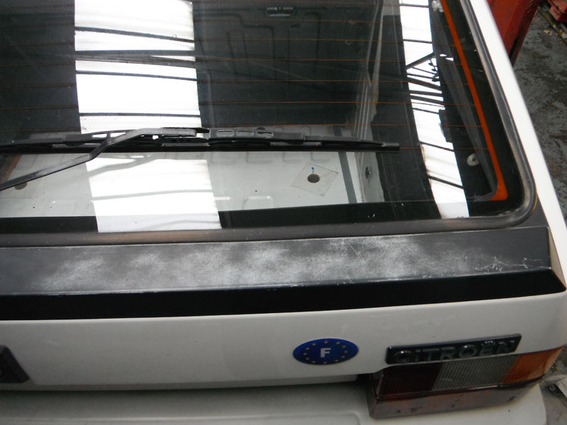

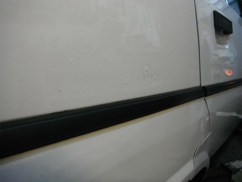

Probably the thing that this car has suffered the most with is sun damage and it's made some of the interior parts brittle. I'll be keeping an eye out for spares and refurbishing what I can. In the meantime, I'm going to be very careful with what's in the car. Unfortunately, even with the best will in the world sometimes brittle plastics will just break. When I removed the parcel shelf to inspect the boot, a couple of rivets holding the hinge bar broke and, as I was removing the parcel shelf itself, one of the plastic hinges that holds onto it on the back seat shattered. I also found a random bit of broken plastic that looks like it might be from one of the front seat back trims, I just haven't found the bit it matches yet.
The rest of the trims came out without incident. While all of the various switches in the BX work perfectly fine, the passenger window over ride on the driver's side could do with either a repaint or a replacement, as could the switches and part of the dash pod.
I've also got to add a bit of sealant to the rubber seal corners to get them to hold down. In the photo it looks rusty, which is odd because it doesn't in person. I'll use a bit of the usual polyurethane sealant and some tape to hold this down for a few hours to a day and that should sort it, the seal is very flexible still, it's just lifted in the very corners. Dean did make me aware of this at purchase, I'm not worried about it since it's not hiding other problems.

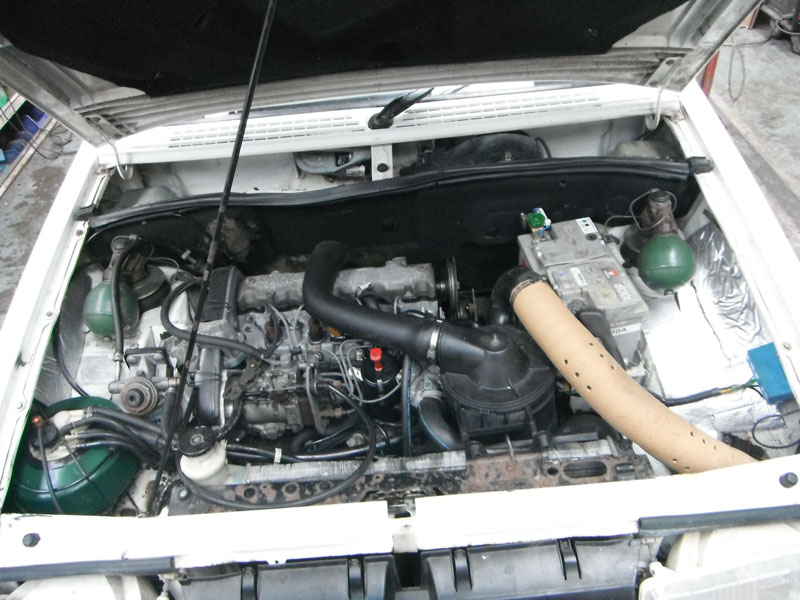

The engine bay is probably one of the cleanest diesel engine bays I've ever seen. There's lots of space to work around everything and see everything. I suspect the rocker cover seal is leaking, as usual, so I'll be replacing that. Otherwise, nothing really appears to be amiss and it's going to be fairly easy to make and keep this area spotless.

There is a lot of info there but as far as the front to rear pipes are concerned it looks to me as though the top pipe and the third one down have been replaced. The 2nd one down goes from the rear suspension 4way to the brake doseur valve. The 4th pipe, the bottom one is a return pipe and not under great pressure it goes from the RHCorrector (you just yank the pipe out by the way) to a rubber return pipe above the front subframe.
I think its important to locate the source of the leak first as you mention its in the rear sphere area which is not really below the front to rear pipes. For example the rear suspension supply pipe can leak as can the rear brake pipe as well as the suspension cylinder itself.

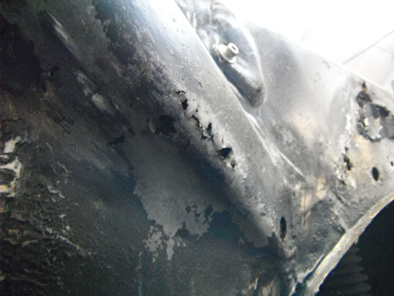

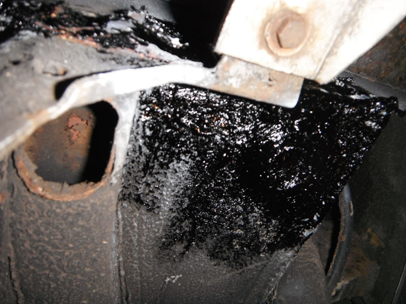

Fortunately, the windscreen surround, and what work the A pillars needed, were done by Dean. He also did some of the sill end work that needed doing. He had intended to do the other work I'm now doing, but with two other white BXs, a couple of XMs, and at least one more Citroen in addition to that he decided to slim the fleet down a bit. He was really honest about the car and so far I haven't found anything I didn't already know about with the exception of the boot repair I completed today, which wasn't really even visible from outside and I only found it because I went looking for it.
If my old estate taught me anything it's that you have to nip rust in the bud on BXs if you stand any chances of keeping them in good health. The metal is so thin that the rust just gallops through when it gets hold so you really can't afford to put off repairs. Thankfully, construction is relatively simple so repairs are generally very easy compared to some other cars I've worked on and I've found the metal on this car is quite nice to weld. You just have to take your time with things, especially with the fumes the galvanised steel can produce, but that's okay because you end up doing a better job as a result, normally.

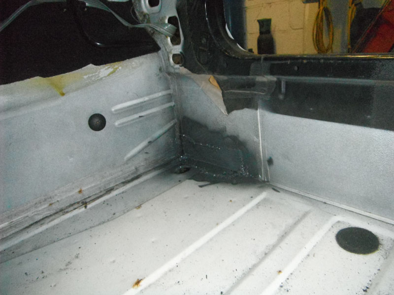

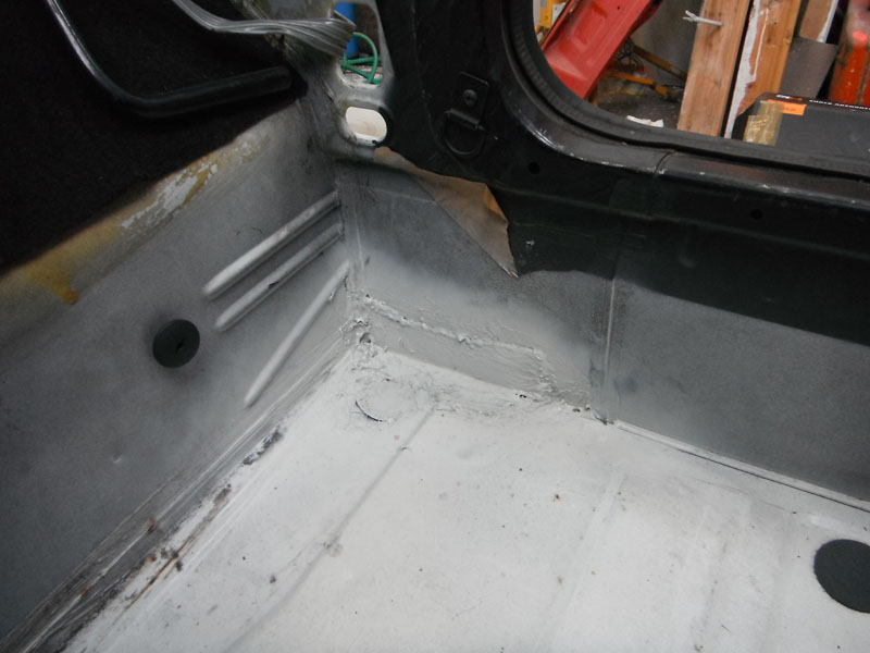

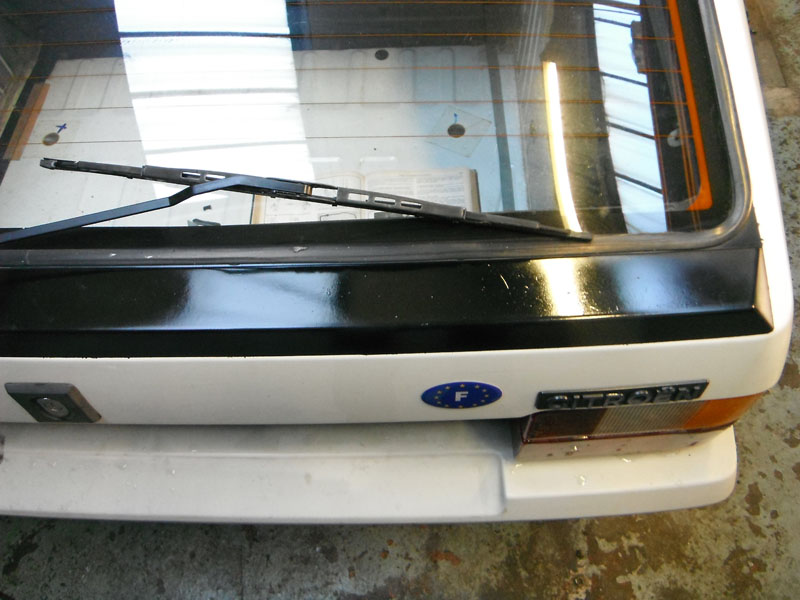

Got cracking on the welding today. I've started in the boot. Unfortunately, I couldn't remove the rear bumper because the fixings were being the usual pain and since I was concerned about breaking things, I left the bumper on and just worked from inside the car instead. This way I got the repair work done in the time I had spare instead of spending all day fighting with the bumper. It's not a factory style repair, I just let in a suitable patch with a 90 degree bend rather than mimicking Citroen's construction. Sploshed some zinc rich primer on once welded (no close up, it looks like I used a pigeon) and then had just enough time to seam seal it on both sides after this photo was taken. Happily, the passenger side spot didn't need any welding as once it was cleaned back the metal was good and it just needed a bit of fresh sealant to replace the bit that had lifted.
I would have liked to got the boot repairs painted and all the trim back in but it was too dark and too cold in the unit to really see what I was doing so I'll leave things as they are for now and come back to it tomorrow, most likely. I did discover the colour of the BX is Alpine White rather than Polar White and Halfords stock a reasonable match for the areas I'm working on, so I grabbed a can of that today. I didn't have time to do more welding work, and couldn't do more painting work, so I started dismantling the worst part of the car I knew about by first pulling out the headlight and indicator pod and then unbolting the front wing. I was pleased to see the wing is actually in very good shape, with just some very minor rust staining to treat and repaint to keep it this way.

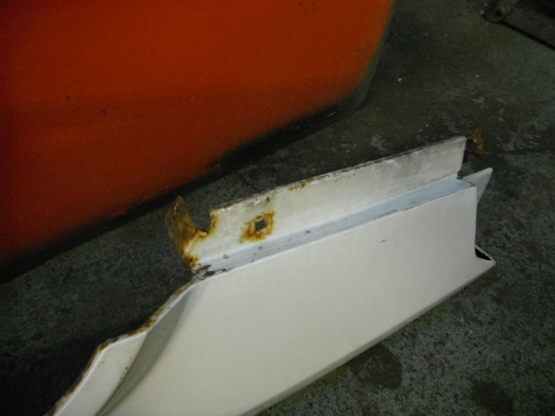

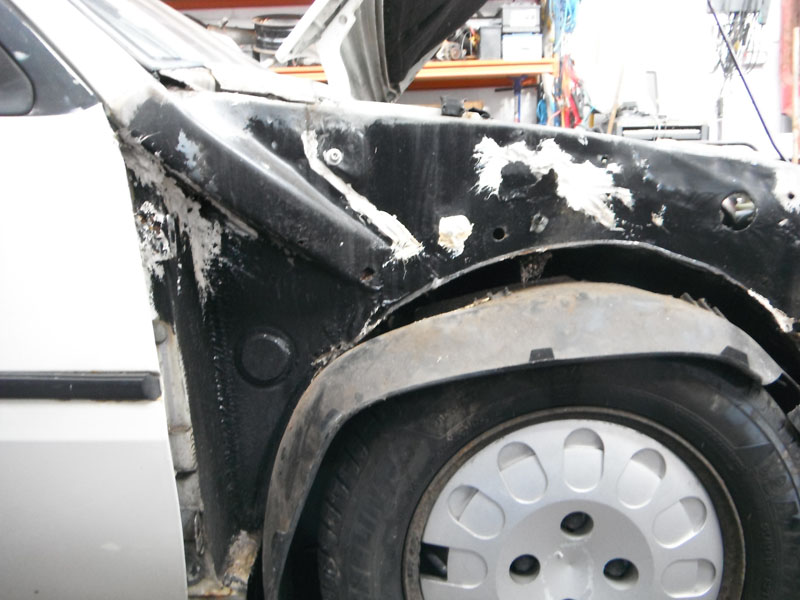

With the wing off, I got to see a bit of rust that I wasn't aware of, but wasn't surprising, which is where a couple of skins join. It should be a straightforward repair since access is very good, the cleaning up is likely what will take the most time on this. The reason it's a funny shape like that is that's the line of a seam where two panels overlap. This is a fairly common spot, as far as I'm aware. The other side of this is a panel seam with a smear of white sealant over the top of it.
I expect the other side will be a similar, but less bad, story. Better to deal with this stuff now and have it done. I'm hoping to get in tomorrow and get some progress on the front end and get the boot repair painted and all the interior back in, I don't want to have too much of the car apart at a time.

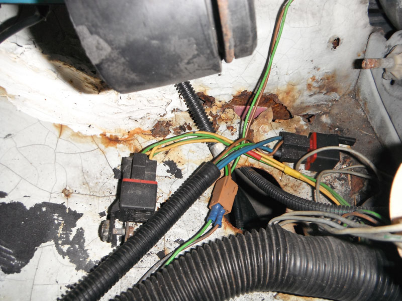

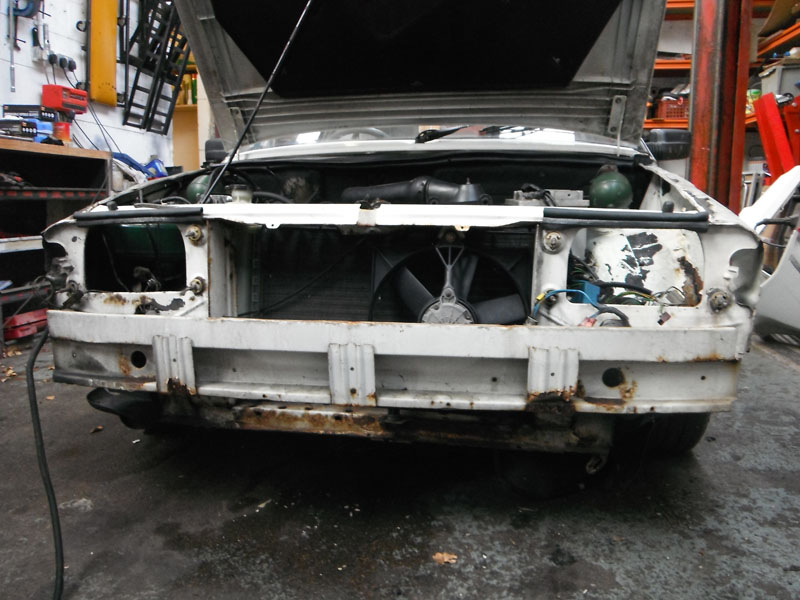

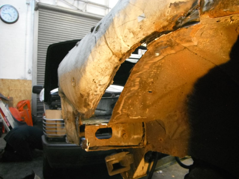

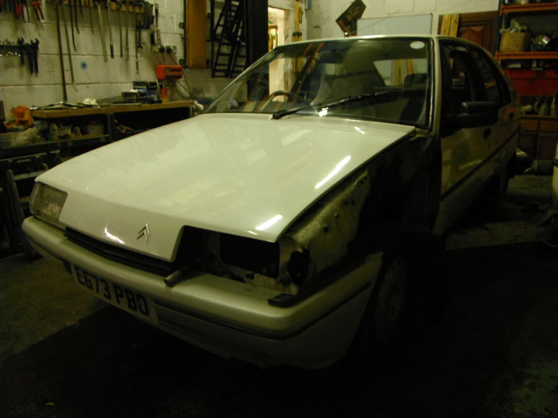

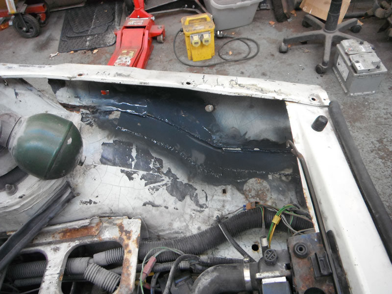

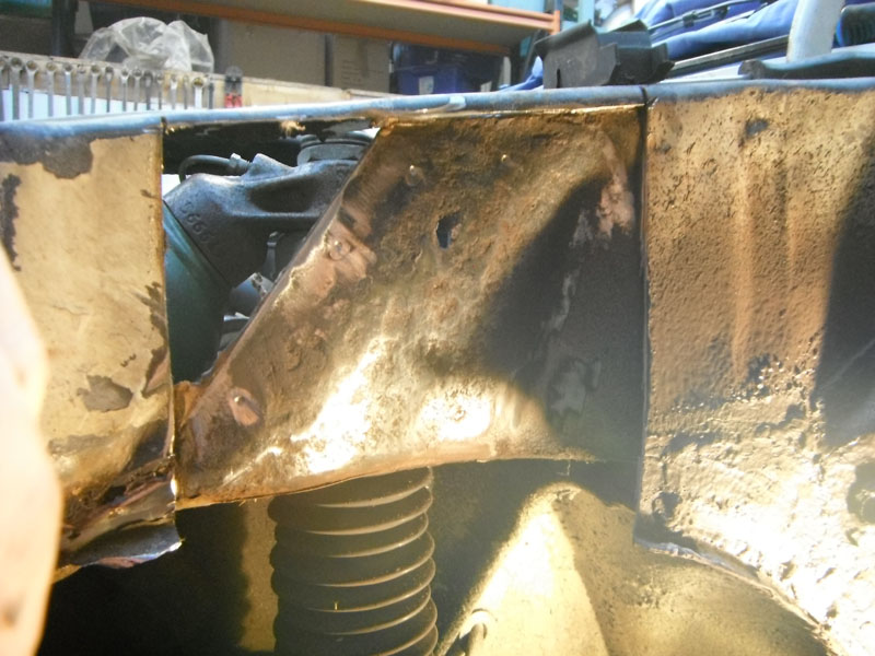

Then I decided the best course of action was to strip the front end down. I was going to have to take the bumper off anyway to sort out the passenger side, and it was so easy to remove the rest of the panels and lights it would have been daft not to do it all in one go. Lots of cableties where captive nuts and bolts should be, presumably because the daft captive bolts Citroen used had all pinged off in that way they do. I found a little extra work to be done in the front crossmember, nothing serious and all easy access stuff. Overall, it's in pretty good shape.

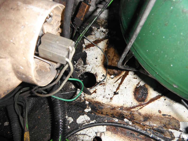

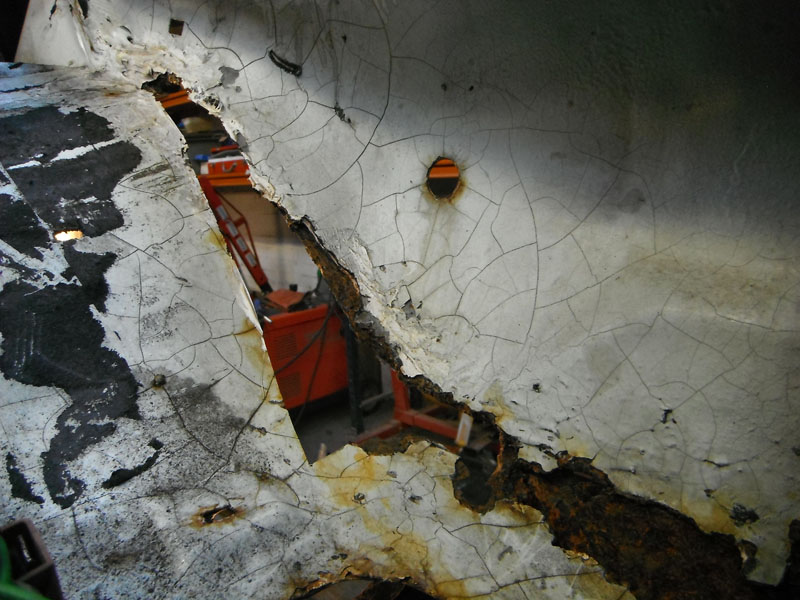

Next to have a look at the driver's side inner wing. Dean had warned me it needed work in here, it was on his to do list, so I wasn't surprised to find stuff to do. More of that white sealant stuff had to be dug out and it revealed a handful of smaller patches required of the usual sort. The worst bit is on the outer wing side of the inner wing where the suspension sphere sits, a common place for BXs to go and not terribly involved to repair. Happily, the front lower part of the wing that the bumper slots into is in excellent shape and will provide a perfect pattern for rebuilding the passenger side. Here's some before and after shots.
This had all taken rather longer than you might expect, so I wasn't going to get any welding done today. Instead, I focused on getting things started on the passenger wing, so the first job was to explore the rusty bits to see what I was dealing with. The bumper hanger on this side had sat in a modified bit of bracketry wedged into the rust hole, which worked and wasn't done in a way that damaged the bumper or original hanger. I'll now just be putting it right again with fresh steel. Thankfully, the reference point for the bumper slot on the leading edge hasn't rotted away so I shouldn't have too much trouble lining the repair piece up in the correct place. Everything from the suspension point back looks in good shape, there's been at least one reasonable repair made that I don't see any need to redo.
With things explored, I had enough time to start chopping out the rusty bits. Almost every piece I need to replace is flat, with excellent access, so this should be about as enjoyable as these jobs get. I chopped out quite a large square for the piece next to the suspension. This was so it would be easier to both clean up the inner skin which needs a small patch letting in, and so I could more easily weld in the repair patch which I'll make out of fresh steel.
I then started cutting back the rust in the inner arch. Again, this is a much simpler shape than it first appears since it's essentially a long curved rectangle for the most part and won't be difficult to fabricate.
From inside the engine bay you can get an idea of access a bit better, especially now I've moved the wires out of the way. The little outrigger type piece under the car is still really solid so I just need to finish trimming out the platform that goes between the headlight and the inner arch where it's rotten so I can let a new square in. That bit will be a little trickier just because I can't dismantle things further for access, other than that it should be easy enough to repair since it's just another rectangle to go in here with no fussy bends and wiggles.
I saved the pieces I cut off for reference, even though I can template from the other side if needed, there's nothing of them I can really use again beyond that.
Then it was time to go home. Car looks a bit forlorn with all the front stripped down.
