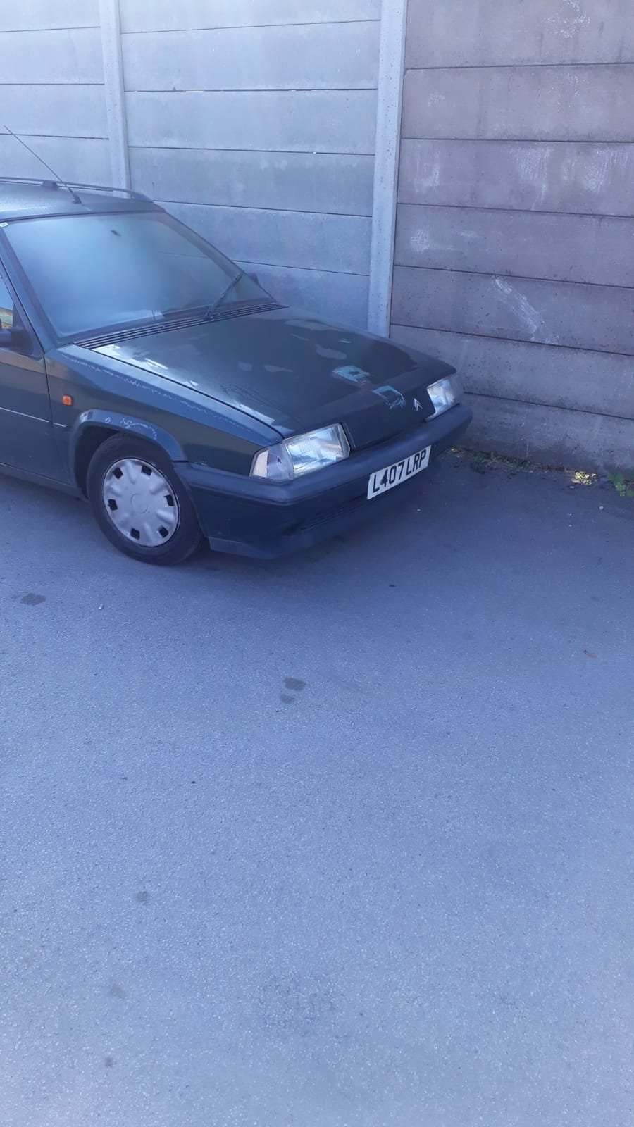

Question about this car that has a leak near the front from the return pipes.
The car does rise, but then the LHM all leaks out pretty fast.

Well, what is the most likely cause?
- Posts: 2034
- x 117
Re: BX Estate
Return pipe leaks at the front are usually easy to fix and can be best found by inspection. Its most commonly the front strut return pipes but can be the safety valve return or the T just above the subframe on the LHS or of course the octopus. Run it with the suspension on low to eliminate suspension leaks.
