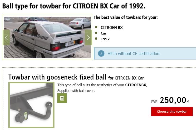

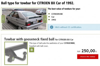

A call to a friend in the trade here cautioned against buying the hardware and getting someone to sign-off the fitting, as that was only the tip of the bureaucratic requirement. He did, though, recommend an outfit in Malaga (less than an hour's drive away) that both manufactured, fitted and provided all necessary paperwork to satisfy ITV (MoT) Testing...
https://www.lafuente.eu/towbars/citroen/bx/car/1992
. To this cost needs to be added €11.50 for the 7-pin electrics, and €150 for the "Technical Project paperwork" that needs to be created in lieu of CE certification. So, all in, it'll be around €500, including IVA/VAT. Expensive, but no real alternative here. At least it will be legal, and safe.
Lafuente will be manufacturing the bar themselves, and fitting it.
They also export their products, should anyone be interested.
