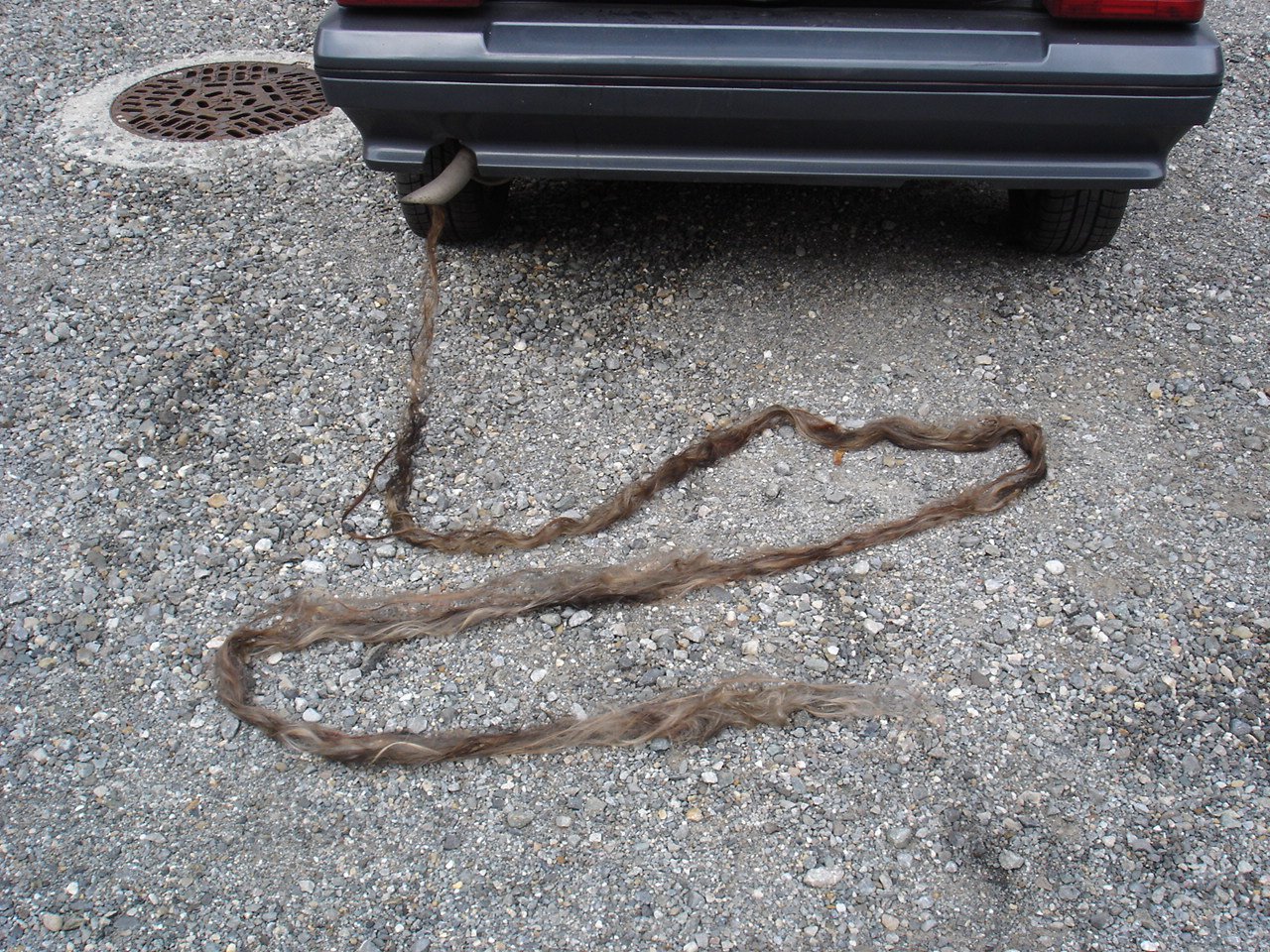

The cross box seems to be an expansion box with the input gas having a perforated tube into the silencer, this tube may or may not have some insulation around it but it just vents into the box and finds its way out of the exit connection. I presume that removes a bit more noise than a straight through/sports silencer whose aim is to produce the minimum flow through without worrrying about higher noise levels.
The rear box is a straight through design but it is packed with fibre glass as well.
