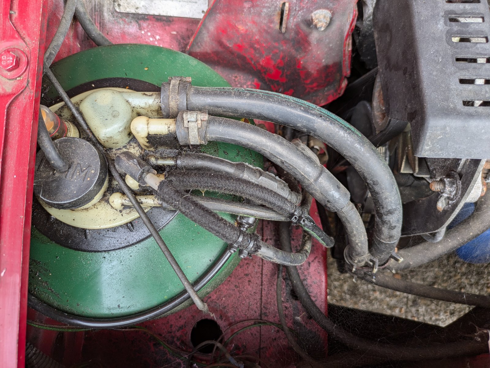

If anyone could point me in the direction of the correct hydraulic pipework I need to stop the leaking that would be much appreciated, the pic below shows the 2 lines which had split and I've spliced in the short lengths of other hose to make it useable temporarily.

Those two lines are part of and go back to the main octopus. New octopi are available from Chevronics. But it is a lot cheaper to splice in a new section as you have done. The fuel hose you have used will do the job but you can get better looking non braided hose from Pleiades or you could give Thames Valley Hydraulics in Didcot Southmead a try.
I have got a big stash of parts should you find you need something for your fettling.
Best of luck with it.
