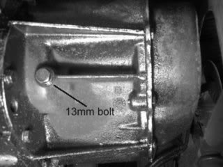

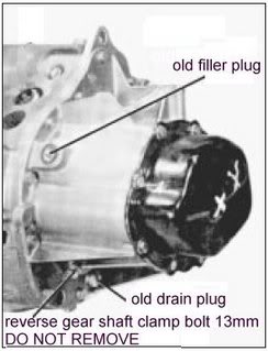

If you follow the Haynes manual instructions, there is a chance that you will confuse the reverse gear shaft 13mm clamp bolt with one of the drain plugs described in Haynes. DO NOT REMOVE THIS BOLT.
reverse gearshaft clamp bolt

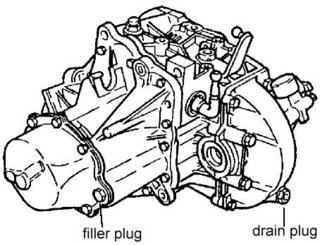

The Haynes manual refers to the old pre 1986 gearbox which had two drain plugs, one on the differential housing about an inch from the front of the subframe, the other on the lower front of the gearbox. The newer gearbox uses only one drain plug, the one on the differential housing. Also, the filler plug has been moved to the gearbox end cover facing the wheel. In this new position. accessed via the wheel arch, it also acts as an indicator of the correct oil level by filling until oil is just about to overflow through the hole (make sure the car is level).
