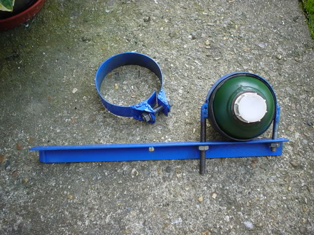

If you are in the Xantia game long-term, go to Pleiades and buy their tool
Alternatively, get a length of square 1" box-section steel and a length of studding and make up a tool. Form the studding into a hoop of the sphere diamater, drill two holes in the box-section and clamp this lot onto the sphere. That'll do the trick.
Chain and strap wrenches have too much "give" in them to work well. The secret is to get a very tight clamp onto the sphere.
Another trick: Have the end of the removal tool so positioned that you can give it a sharp shove from your boot

If you are in the Xantia game long-term, go to Pleiades and buy their toolThat tool is guaranteed to remove any sphere, however tight!
