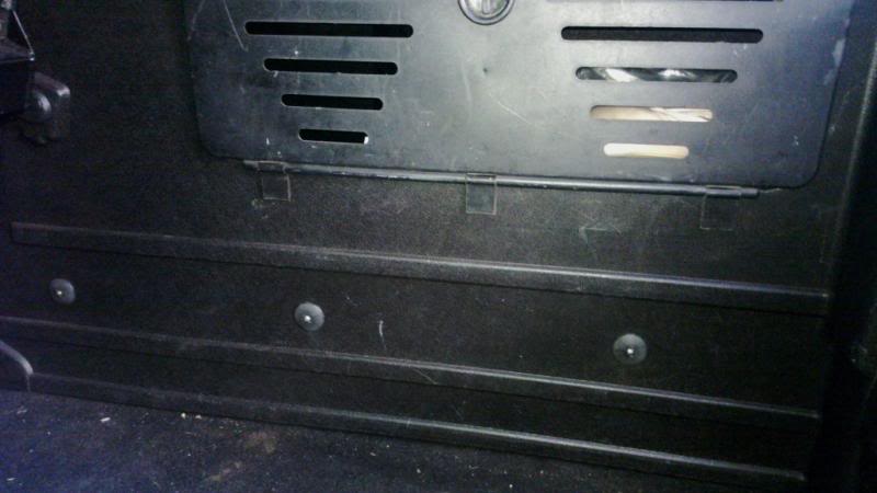

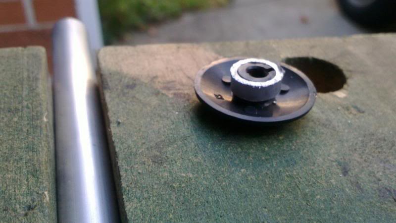

Here is a way to get those plastic nuts to grip again.
I cut some 12mm x 1.6mm aluminium tube into half a dozen 5mm long pieces, slipped onto the business end of the nuts then crimped slightly perpendicular to the split in the plastic. They grip very well and can be tightened properly.
No more rattly boot liner!
Only problem is the hardware store only sells 2.0 meter lengths and I only needed 30mm ! Maybe I will fix another 65 cars?

Re: Plastic nut thingumys
Ah, it's finally clicked what people were suggesting with the nuts after seeing Michael's pictures. Guess what I'll be doing tonight!
Aha, it now makes sense with those piccies, thank you :)

Did mine today, the 12mm tube didn't work quite as well, so ended up using a bit of chemical metal inside the thread which seemed to work well in the end.
I think it wants slightly smaller tubing than I had.
They certainly grip OK now

Did you crimp them? like michaelr did?

I just discovered today that i had used metal (steel in my case) tubing also and I crimped (or rather more crudely) squashed mine with mole grips to close the gap a tad. I only have 4 though so I have a few more to do (some for the valver)

Yes, squashed them, perhaps more care was needed?, worked ok though with a dap of epoxy stuff in the end.
