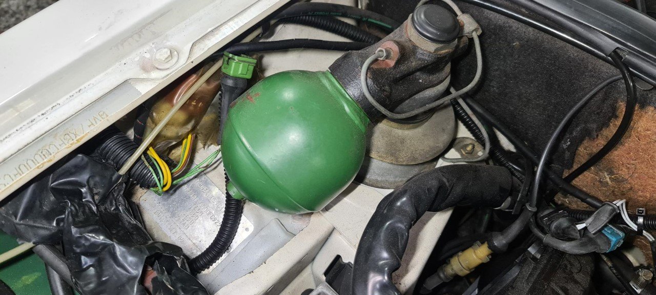

sorry couldn't find this two-pin plug, do you have a picture what it looks?RobC wrote: Tue Sep 07, 2021 3:55 pm Btw the 2 pin diagnostic socket for Ml4.1 ECU 16v is in theory to be found on the left of the engine as you look at it (ie cambelt end), near the engine mount.
how can I post or insert pictures here?

Glenn_a
- Posts: 8
- Joined: Mon Sep 06, 2021 3:09 am
- Location: Sydney
- My Cars: Citroen BX 16valve
Re: BX 16 Engine light idle fluctuate
is this the diagnostic connector? (green in colour)
