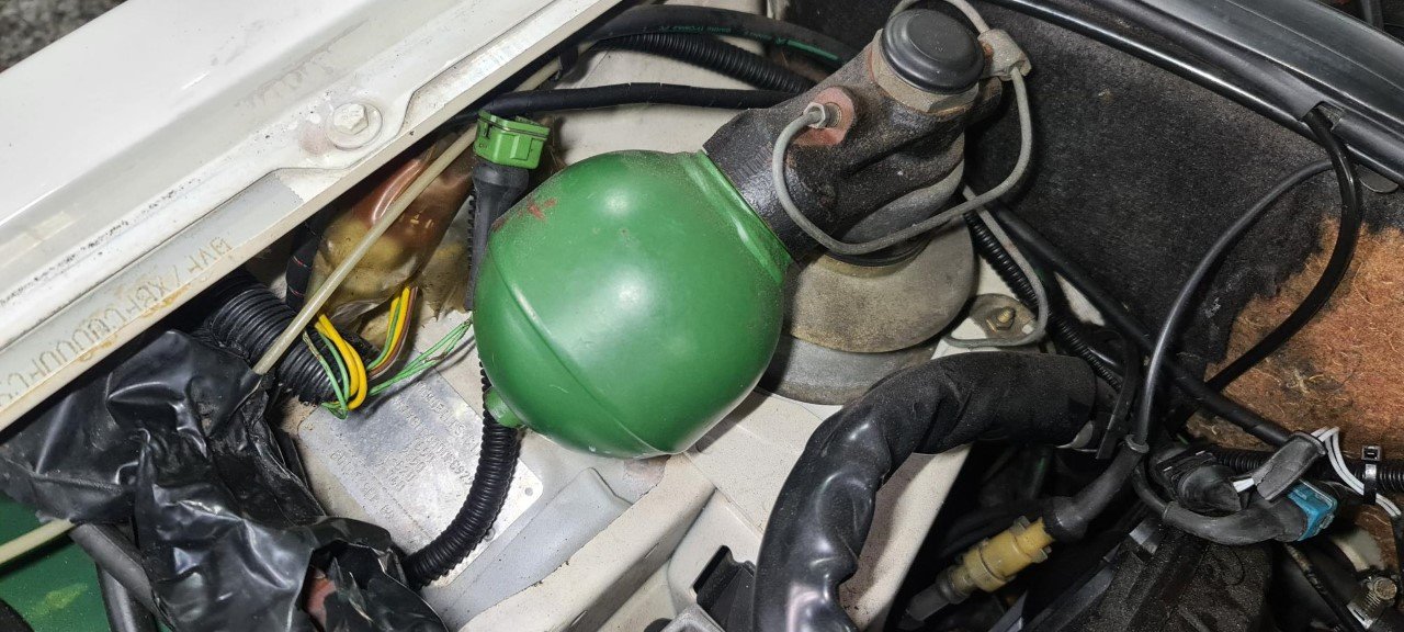

Thanks Dave_16v and RobC for all your effort to help 👌 ill look into that RobC check list and go from there but for now need to know the error code and need to find that plug. Dave_16v mentioned some are green color? I think I found that plug and it looks like a injector plug just sitting on the RH near engine mount. I wish I can attach pictures, how you guys can attach picture anyway? Thanks again🙏

Glenn_a
Posts: 8
Joined: Mon Sep 06, 2021 3:09 am
Location: Sydney
My Cars: Citroen BX 16valve
Re: BX 16 Engine light idle fluctuate
Post by Glenn_a »
is this the diagnostic connector? (green in colour)
